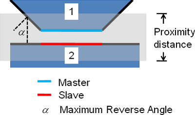

| Proximity distance | Generates contact pairs between components that are closer to each other by less than the specified proximity distance. |
| Use shell thickness for 2D elements | If activated, the shell thickness values will be used for 2D elements instead of the specified Proximity distance. 3D elements will still use the specified Proximity distance. |
| Max reverse angle | Excludes elements in the contact when the angle between the
normals of two elements, or element faces within the proximity
distance exceeds the specified reverse angle value. Default value is 15 deg. |

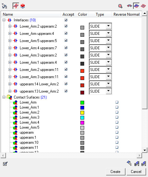

The Auto Contact Browser provides options for reviewing and modifying contact interfaces and surfaces found by the Auto Contact tool.
Auto Contact Browser Columns
| Column | Description |
| Name | Lists the names of all of the contact interfaces and surfaces
found by the Auto Contact tool. Underneath each contact interface name is the temporary master and slave surfaces associated to that interface. Red indicates a slave surface, and blue indicates a master surface. Renaming entities, as well as Master/Slave surface swapping is possible via the context menu. |
| Accept | This checkbox defines whether or not a contact interface will be included in the creation process once you click Create. |
| Color | Color that will be assigned to the contacts and contact surface entities. |
| Type | Type of CONTACT assigned to each contact interface. |
| Reverse Normal | This checkbox defines whether or not the normal direction of the given surface should be reversed or not. When OFF (default), surfaces on 3D elements will be pointing outwards, and surfaces on 2D elements will point in the direction of the element normal. |

In the Proximity distance field, enter a value for the proximity
distance.
Contact pairs will be generated between components that are closer to each other by less than this proximity distance.
In the Max reverse angle field, enter a value for the maximum reverse
angle.
If the angle between the normals of two elements or element faces within the proximity distance exceeds this value, the element will not be included in the contact. Default value is 15 deg.
Figure 2. Definition of Proximity Distance and Maximum Reverse Angle -

Use the Auto Contact Browser to review all of the found interfaces and make any
necessary adjustments to contacts and contact surfaces. When you are finished,
click Create.
Contact surfaces and contacts are created for all items marked as Accepted. Clicking Cancel will close the Auto Contact Browser without creating any contacts.
