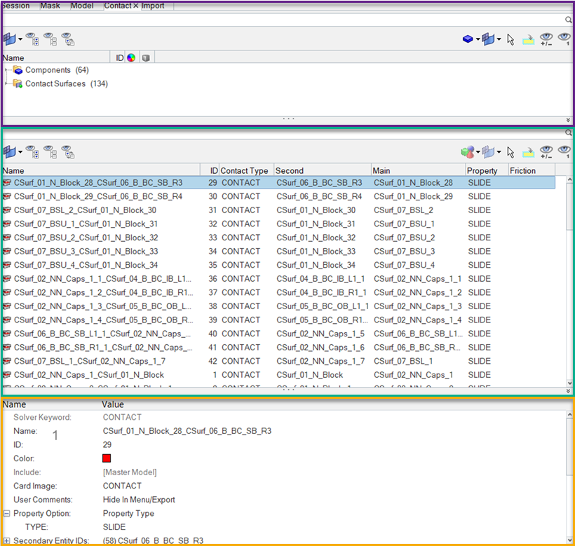

Browser Interface

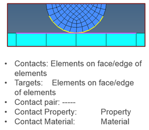

- ANSYS contact regions are modeled like ordinary FE elements over the regions of FE models that represent the geometry. In ANSYS terms, both CONTACT and TARGET surfaces are sets of elements at contact regions. Prior to HyperMesh 14.0.130, the ANSYS interface supported the same principle as ANSYS, therefore both CONTACT and TARGET regions were elements over model geometry in HyperMesh.

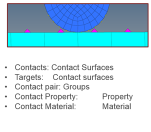

- Starting in HyperMesh 14.0.130, both contact and target regions are identified as CONTACT SURFACES. A pair of contact and target surfaces which interact with each other in analysis are GROUPS. You need to create contact surfaces for both CONTACT and TARGET regions. They will then be paired together under groups to successfully define the contacts. ANSYS solver files (*.cdb files) with contacts are imported into HyperMesh, and identify the contact regions from the contact elements to show the regions as contact surfaces. Contact pairs can be seen in groups.

Figure 5. HyperMesh 14.0.120 and Earlier
Figure 6. HyperMesh 14.0.130

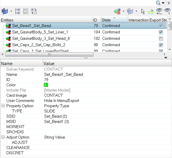

Nastran
- The AutoContact option will create new contact cards using their default values.
- When reading legacy models (.bdf, .dat and .hm), old contacts will be mapped to new contact cards.
- Contact parameters in the BCTABLE card are mapped to equivalent contact properties (BCONPRP and BCONPRG) in new contact cards.
- Properties associated with BCPROP should be assigned to either elements or respective components in the contact card.
- You can export old contact cards by enabling the Export old Contact Card checkbox, which can be accessed in the in the Export-Solver Deck Browser when you click Select Options.
- The Contact group entity is mapped to the BCTABL1 solver card.
- The BCTABL1 solver card contains a list of contact pair (BCONECT) cards.
- The AutoContact option will create a BCONECT card for each pair, and group all pairs in the BCTABL1 card.
- BSURF and BCBODY1 solver cards are remapped from group entities to set entities.
- BSURF and BCBODY1 are combined into one entity. Input for BCBODY1 can be defined in the BSURF card with the Entity Editor.

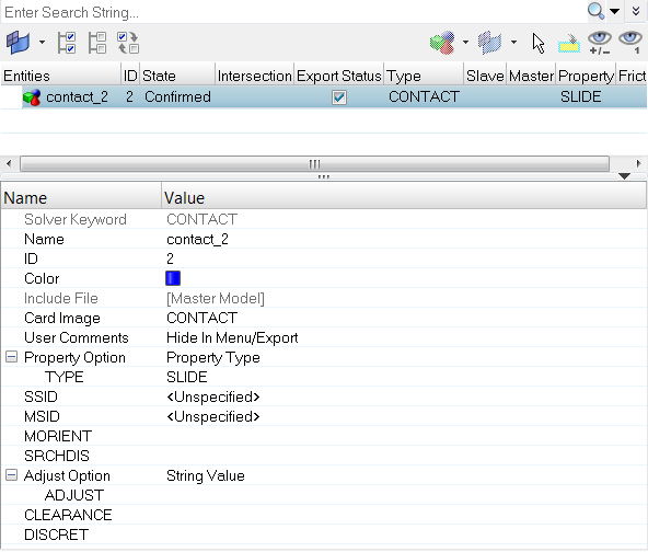

OptiStruct
- The Contact type Touch creates a contact pair, and the Contact type Gap/Tie creates a Tie contact.
- Master ID and Slave ID types will be as per solver default Set of elements for master ID and Set of nodes for slave ID.
- Auto contact will honor the entity type in Master and Slave entity type.
- Master entity types have the following mutually exclusive options: Set of elements or SURF. Similarly Slave entity type will have Set of nodes, Set of elements, and SURF. You can only select one of the entities.
- The Contact property option is only available when the Contact type is Touch.
- You can assign Touch contacts a Property type (SLIDE, STICK, FREEZE), a Static Friction Coefficient, or an existing property (PCONT).
