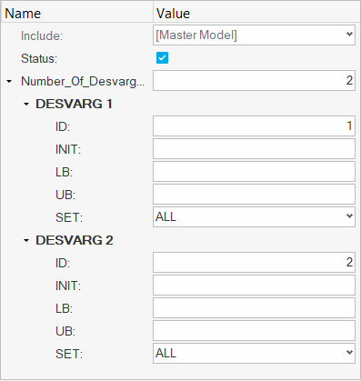

Edit Multiple Entities

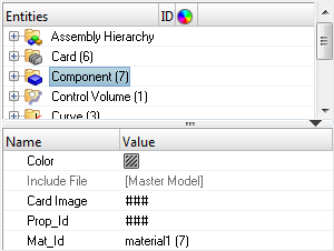

If you select multiple entities in the browser, the Entity Editor opens and displays the selected entities common corresponding data that can be modified simultaneously.
The rows that contain ### indicate that these fields do not contain common data but can still be modified. When you modify the data, both common and ambiguous, HyperMesh applies the changes to all of the selected entities.

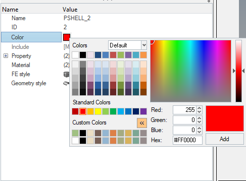

When you create an entity, it is assigned an unique ID, name and color. Use the Entity Editor to edit this data.
| Option | Description |
| Edit ID and name |
![]() Figure 4. |
| Edit color |
![]() Figure 5. |

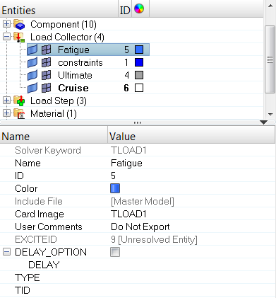

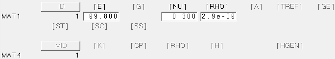

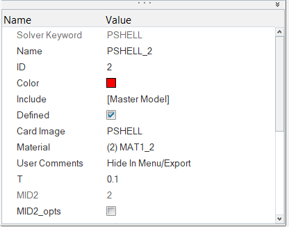

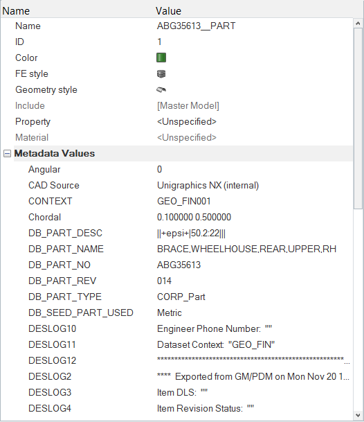

Edit Solver Specific Data (Template Data)
Every entity is assigned solver specific data, which you can modify using the Entity Editor.
Figure 6.

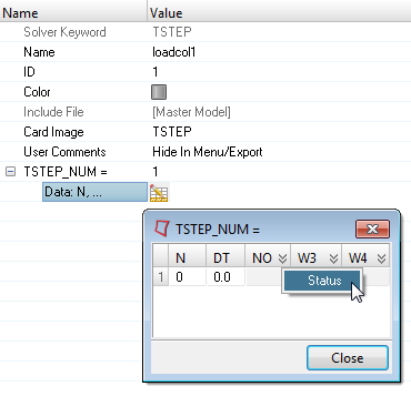

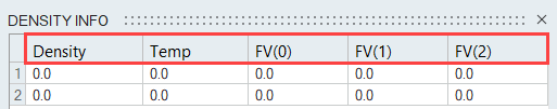

Figure 8. Density Info for ABAQUS_MATERIAL - Certain control cards make use of unstructured tables. In these cases, array
attributes are shown as new categories/columns and data cannot be
imported/exported.

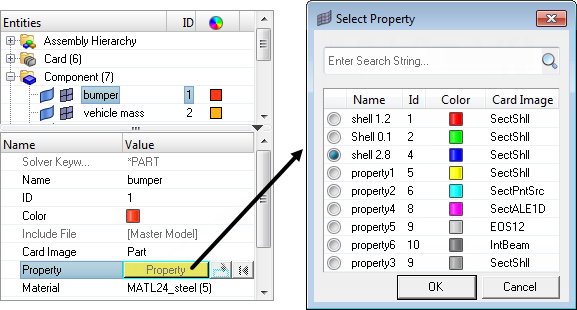

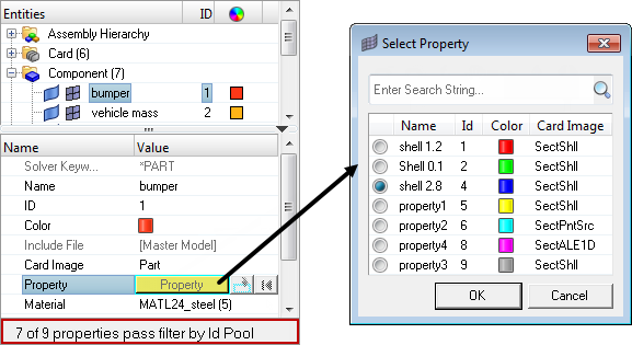

In the Entity Editor you can assign certain entities to another entity or a group of entities.
For example, you can assign a property to a component. When an entity has an entity assigned to it, the name and ID of the assigned entity will be displayed in the Value field. If an entity does not have an entity assigned to it, the Value field will display <Unspecified>.
Figure 19.

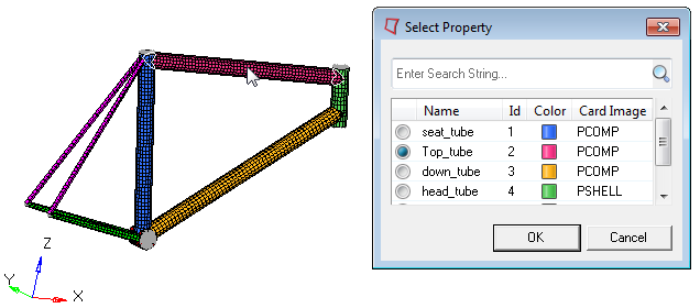

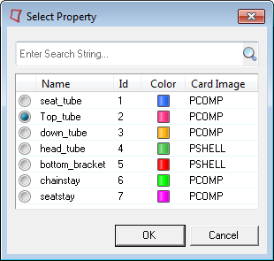

In the Entity Editor, you can assign an entity using the Select dialog or the Entity Selector.
Method 1: Assign Entities Using the Select Dialog
Method 2: Assign Entities Using the Entity Selector

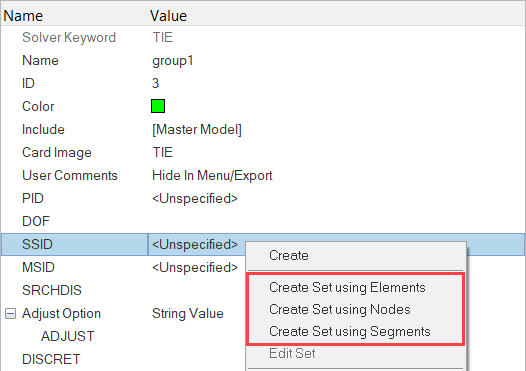

Create and Assign Sets to Main or Secondary Entities

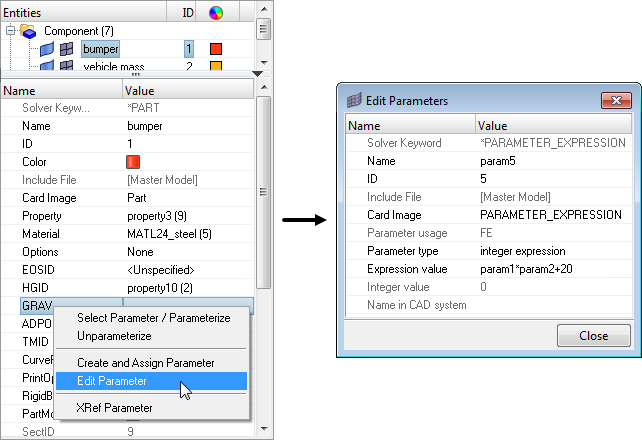

Create and Edit Parameters
In the LS-DYNA, OptiStruct, and Radioss user profiles, certain entities can be defined with parameters in the Entity Editor.

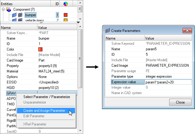

Create and Assign a New Parameter
Edit a Parameter
Parameterize and Unparameterize Entities

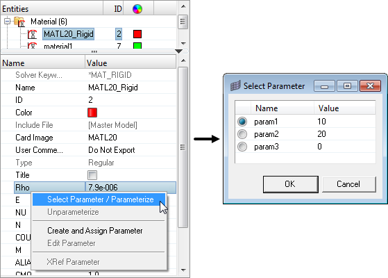

For any solver entity, you can parameterize most of the solver template data of a numeric value in the Entity Editor.
Parameterize an Entity

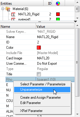

Unparameterize an Entity
Figure 32. Parameter Rho is being Unparameterized with the Parameter param1.

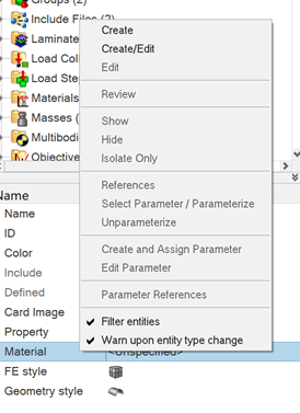

Filter the entities that are not applicable to the entity displayed in the Entity Editor.
Figure 33.
Figure 34.
Warn Upon Entity Type Change
Display a warning dialog when changing information in the Entity Editor.

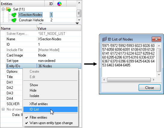

View an ID List for Set Entities
Set entities are used to define and store lists of entity IDs for a specific entity.
Sets can be generated for nodes, elements, components, assemblies, properties, materials, ellipsoids, multibody planes, multibody joints, and multibodies which contain entity IDs for that specific entity. In the Entity Editor, you can view an ID list for set entities. The entity IDs are compacted using ranges, and segregated using ID pools. If some of the IDs are unresolved, than they will be listed separately under Unresolved IDs.

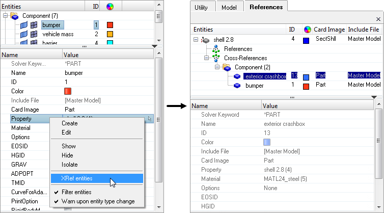

View Xref Entities
Figure 36.
or press
