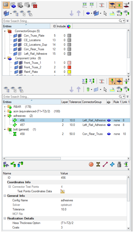

- The Link Entity Browser, located in the first pane of the tab, displays information about all of the linked entities in the model and Connectors groups.
- The Connector Entity Browser, located in the middle pane of the tab, displays a tree view of all the connections the model contains. HyperMesh organizes and displays the connectors in different folders based on their respective realization type. The names of the folders are obtained from the FE configuration names that are specified for respective solvers in the feconfig.cfg file.
- The Connector Entity Editor, located in the last pane of the tab, displays attributes assigned to the connector(s) selected in the Connector Entity Browser.

The actions performed in the Connector Browser, such as selecting, highlighting, showing, or hiding supported entities, are reflected in the graphics area. For example, when you select an entity in the Connector Browser, HyperMesh outlines it in white in the graphics area.
The browser and the HyperMesh database synchronize with each other to ensure that all the changes made to the connector or the supported entities information in the database are reflected correctly in the browser at all times.
The browser can be configured to only display the information you wish to see. The current configuration is always saved, so that when the browser is opened in the future it will contain the same configuration as the last time that it was used.
