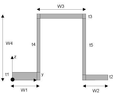

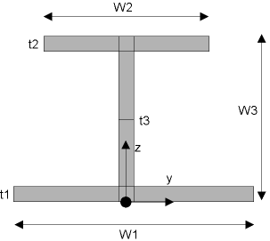

The following images indicate the location of the value fields in the SECDATA card, such as W1, W2, t1 and t2.
Figure 1. I Beam
Figure 2. HREC Beam
Figure 3. T Beam
Figure 4. L Beam
Figure 5. Z Beam
Figure 6. CHAN Beam
Figure 7. CTUBE Beam
Figure 8. CSOLID Beam
Figure 9. HATS Beam
Figure 10. RECT Beam - In the Section dialog, click Close to return to HyperMesh.
