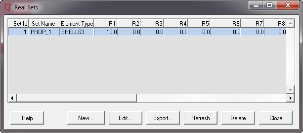

The Real Sets macro creates property card images for all elements that the ANSYS interface supports.
With this macro, you can view the real constant values of existing real sets, create new real sets, and edit the properties and reference numbers of existing real sets.
The Real Sets macro dialog displays the real set, reference numbers, element type of the property set, and the real constant values for that element type.
Rows can be sorted by set name, set ID and the element type column.
