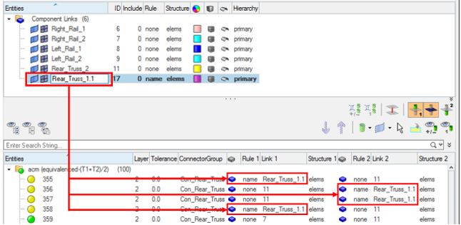

Update Link by Directly Editing Column Data in the Connector Browser
- In the Link Entity Browser, update links for the purpose of part
replacement (link reference) by entering a new link name in the Entities
field or link ID in the ID field.All link references to the old part will be updated to reference the new part in the Connector Entity Browser.

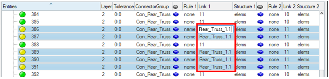

Figure 1. - In the Connector Entity Browser, perform part replacement on single or
multiple selected connectors by entering a new link ID or link name in the
Link column.

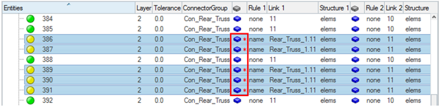

Figure 2.Note: When unresolved entities are referenced in the Link field, a red asterisk will appear next. Once the entity is resolved, the asterisk will disappear.

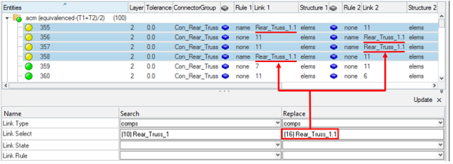

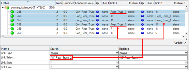

Update Link Using the Replace Link Option in the Link Entity Browser's Right-Click Context Menu
- In the Link Entity Browser, right-click on a link and select Replace Link from the context menu.
- Select a replacement part.
- Click proceed.
- In the Confirm dialog, click Replace.
