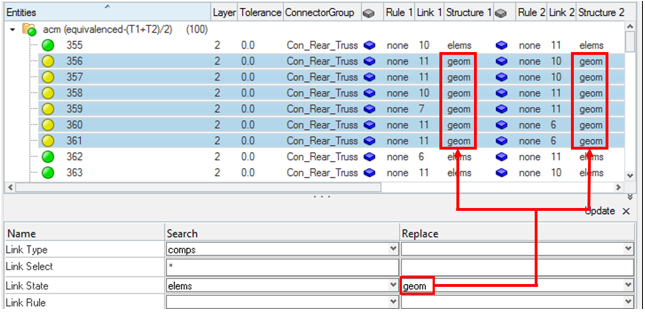

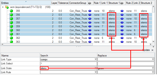

The link state defines if the weld created during connector realization connects to geometry or mesh on the link.
This is applicable to only components and surfaces entities that can contain geometry and/or mesh information.

Update the attributes associated with a link, such as reconnection rule, link references, and link state.
The link rule defines how a connector treats an entity added as a link.
