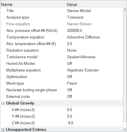

Set the Analysis Parameters

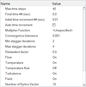

Specify the Solver Settings

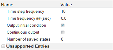

Define the Nodal Outputs

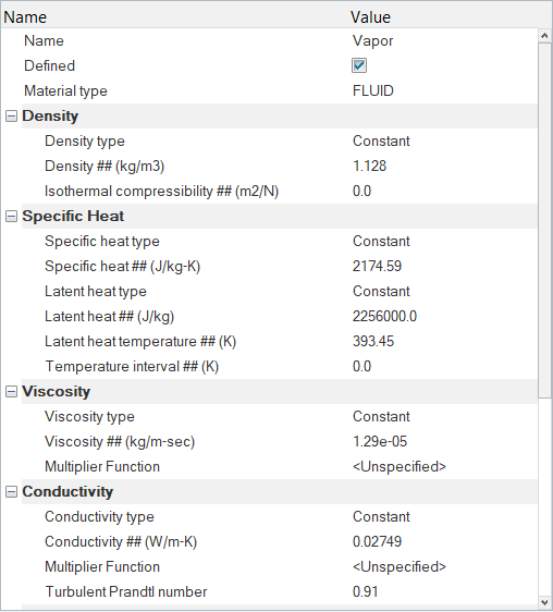

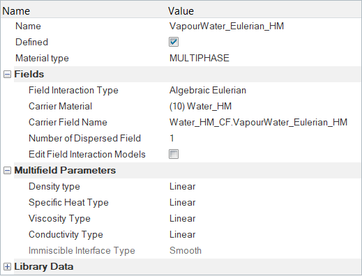

Set Up Material Model Parameters

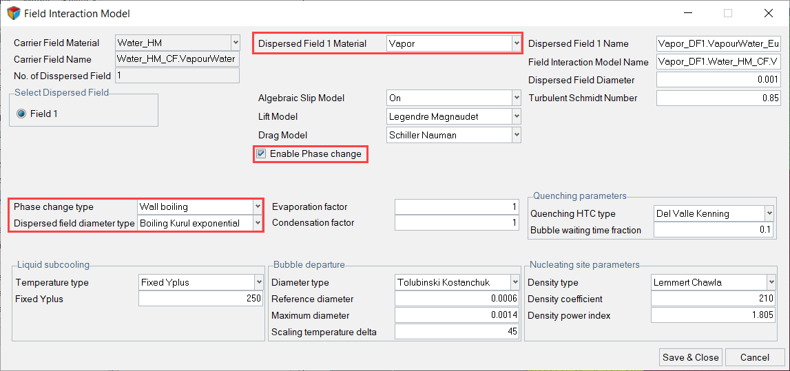

In this step, you will start by creating a new material named Vapor. Then, you will set up the Multiphase material model.

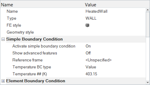

Set Up Boundary Conditions and Nodal Initial Conditions

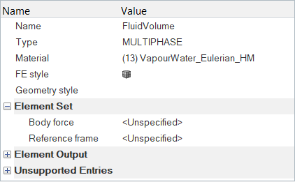

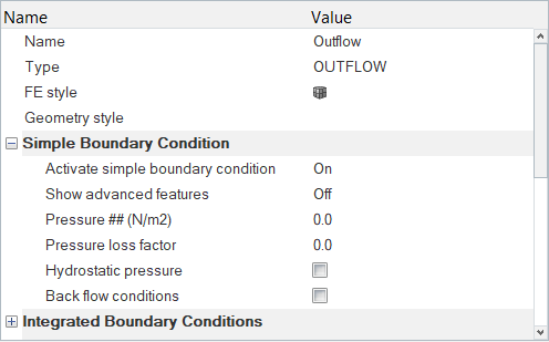

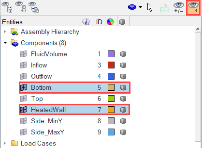

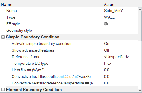

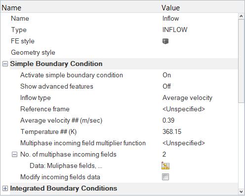

In this step, you will assign the material properties to the multiphase fluid volume and then assign surface boundary conditions.

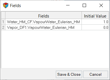

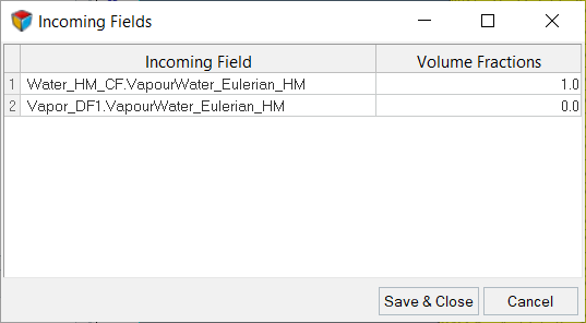

Set the Nodal Initial Conditions

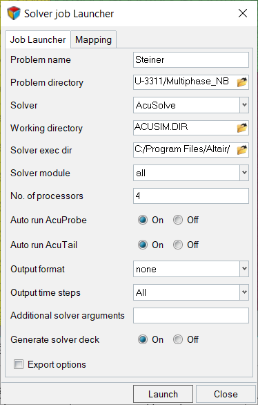

In this step, you will launch AcuSolve directly from HyperMesh and compute the solution.

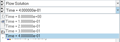

Switch to the HyperView Interface and Load the AcuSolve Model and Results

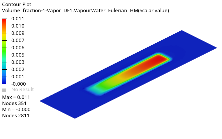

Create Contours for the Volume Fraction of Vapor
Summary
In this tutorial, you worked through a basic workflow to set-up and solve a transient two-phase Nucleate Boiling flow problem using the Algebraic Eulerian multiphase model. You started by importing the model in HyperMesh. Then, you defined the simulation parameters and launched AcuSolve directly from within HyperMesh. Upon completion of solution by AcuSolve, you used HyperView to post-process the results and create a contour plot of the volume fraction.
