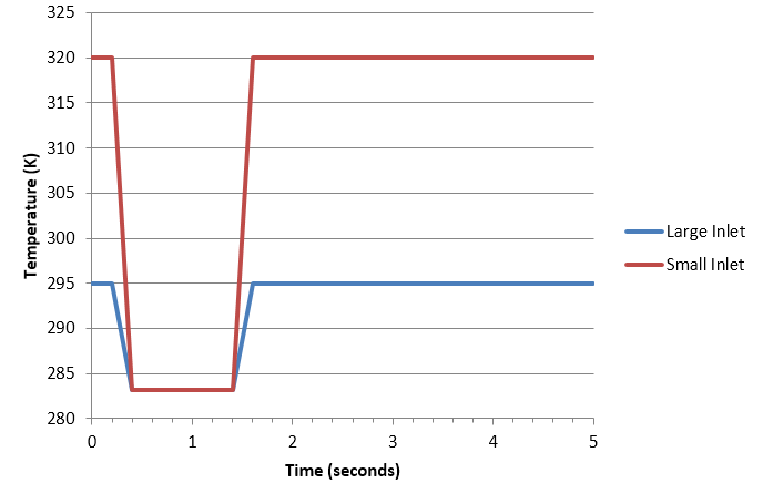

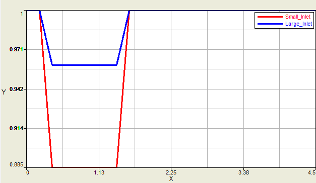

At 0.2s into the simulation, a cold slug of water is injected at both the inlets and the temperature is ramped down to 283.15 K starting from 0.2 s to 0.4 s. Then it is maintained constant at 283.15 K for 1 sec and then ramped up to initial states from 1.4s to 1.6s. Given a flow path of 0.6356 m, the transit time for the slug is approximately 1.6s. Therefore, our simulation time should be at least 3.2 s to factor in the duration of the slug and transit time. The total simulation time will be 4.5s to allow time for the thermal conditions to return to a steady state.
The temperature change at the large inlet is from 295 K to 283.15 K. At the small inlet, the temperature changes from 320 K to 283.15 K. The ratio of the cold slug temperature to the initial temperature of the large inlet flow is 0.9598. The ratio of the cold slug temperature to the initial temperature of the small inlet flow is 0.8848. These values will be used in creating multiplier functions to model the transient temperatures at the inlets.

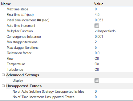

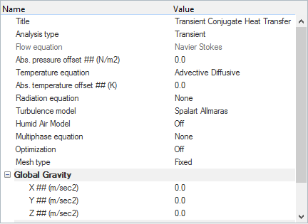

Set the Transient Simulation Parameters
Set the Analysis Parameters
Specify the Solver Settings

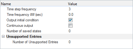

Set the Nodal Output Frequency

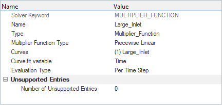

Create Multiplier Functions
First, you will create curves for the scaling function to be used for the Multiplier Function type.

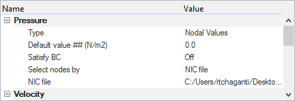

Specify the Nodal Initial Conditions
In this step, first you will specify the initial values of Pressure, Velocity, Temperature and Eddy Viscosity at all nodes and then Transient BCs for both the inlets.

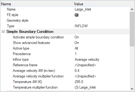

Specify the Transient Inlet Boundary Conditions

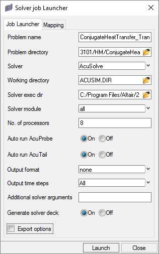

Compute the Solution
In this step, you will launch AcuSolve directly from HyperMesh and compute the solution.
Run AcuSolve
