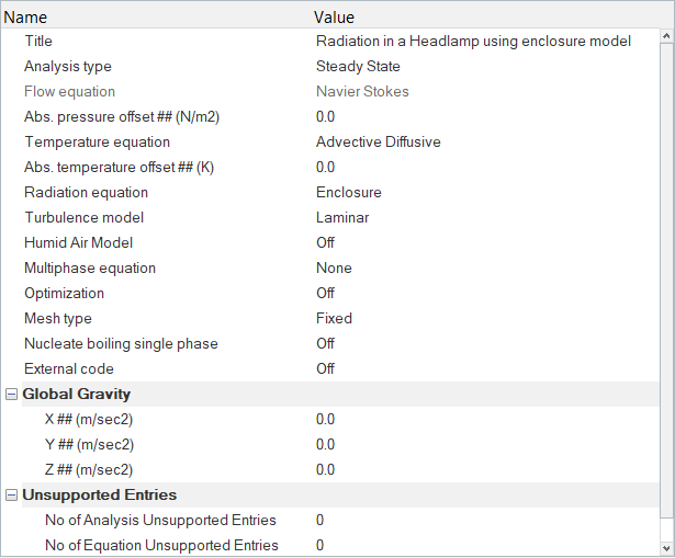

Set the Analysis Parameters
Specify the Solver Settings

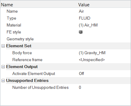

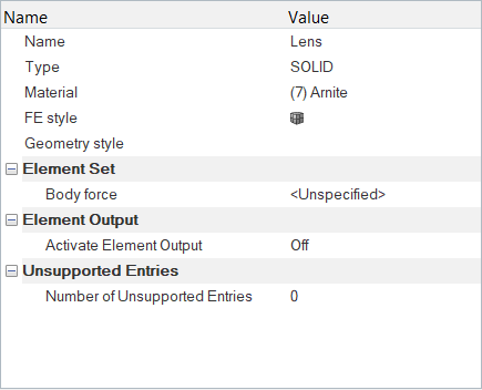

Define the Material Models and the Body Force
Define the Body Force

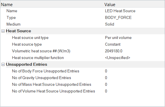

Define the Heat Source

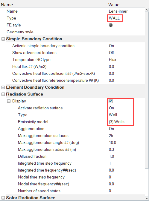

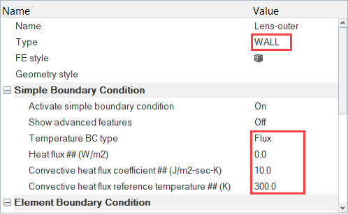

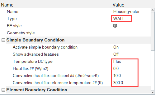

Set the Boundary Conditions

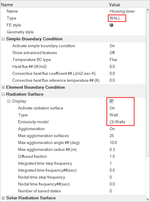

Create the Emissivity Model

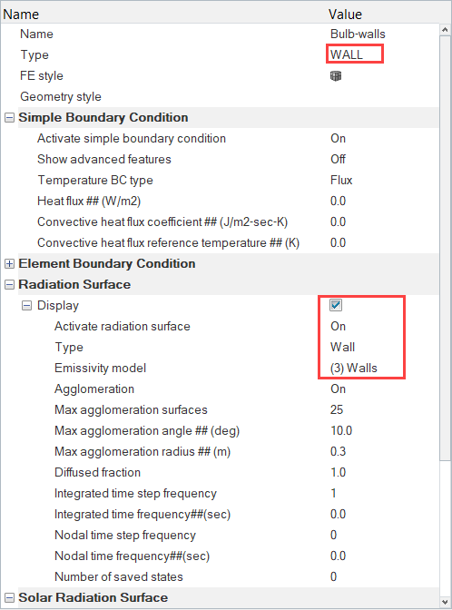

- In the Solver Browser, right-click on 07.Emissivity_Model and select Create.
- In the Entity Editor, name it Walls.
- Set the Emissivity to 0.7.

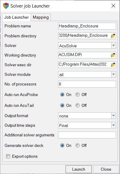

Run AcuSolve
In this step, you will launch AcuSolve to compute a solution for this case.

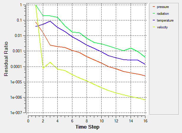

Monitor the Solution with AcuProbe
While AcuSolve is running, you can monitor the progress of the solution using AcuProbe and plot the values of residual ratios, solution ratios, and variables like temperature, heat flux, etc. Once the solver run has started, the AcuTail and AcuProbe windows should be launched automatically.

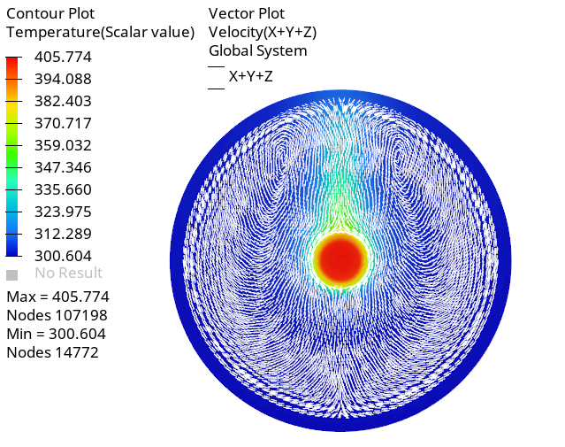

In this step, you will visualize the results using HyperView. While doing so, you will create contour plots of temperature and velocity magnitude on a section cut and also create a plot of velocity vectors. Once the solver run is complete, close the AcuProbe and AcuTail windows. In the HyperMesh Desktop window, close the AcuSolve Control tab and save the model.

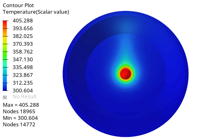

Create a Contour Plot of Temperature

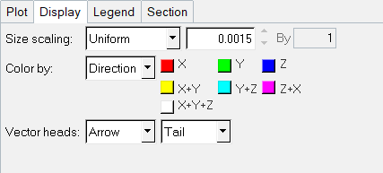

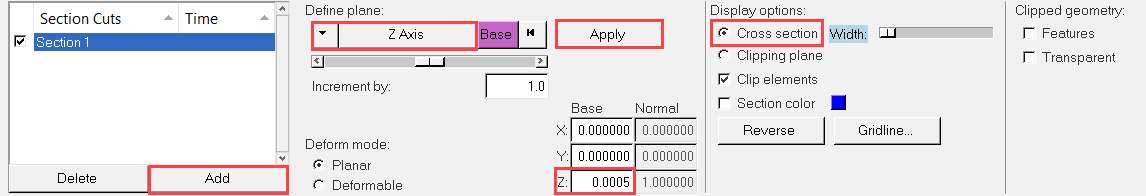

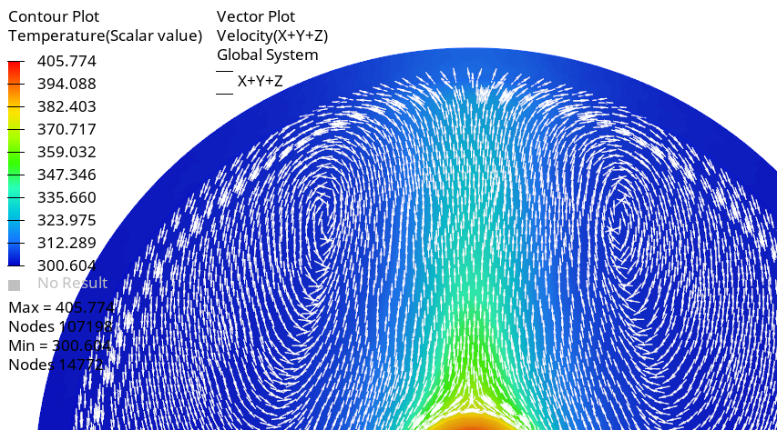

Display Temperature Contours and Velocity Vectors on a Section Cut
In this step, you will create a section cut on the mid-z plane and then display the temperature and velocity vectors on that cross section.

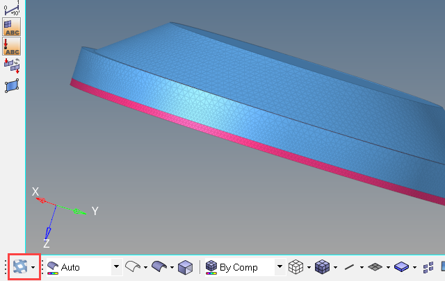

on the Standard Views toolbar.
