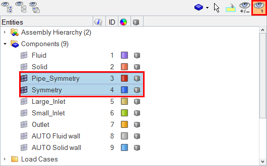

Open the HyperMesh Model Database

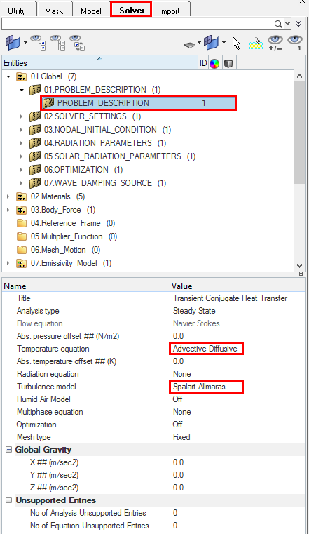

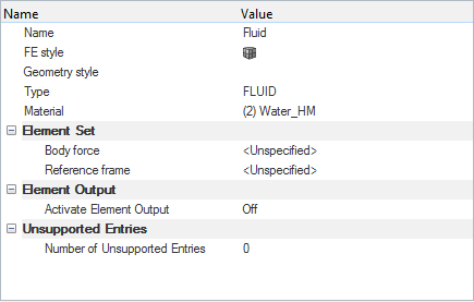

Set Up Boundary Conditions and Material Model Parameters

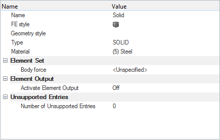

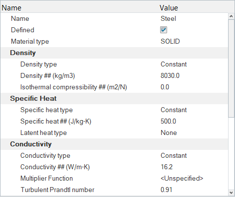

In this step, you will start by creating a new material, then you will define the surface boundary conditions for the problem and assign material properties to the fluid and solid volumes.
Create a New Material Model

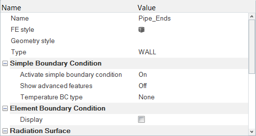

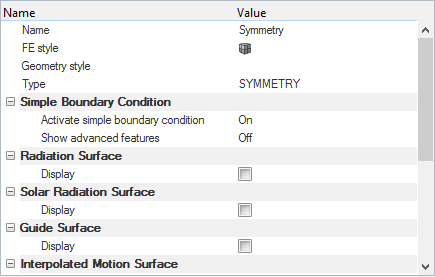

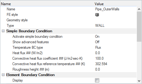

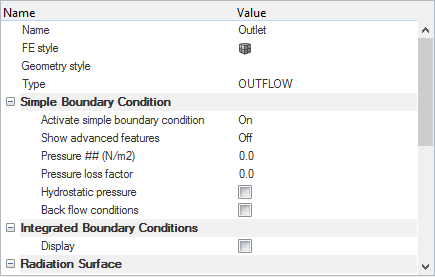

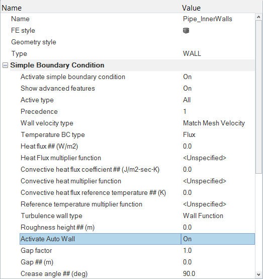

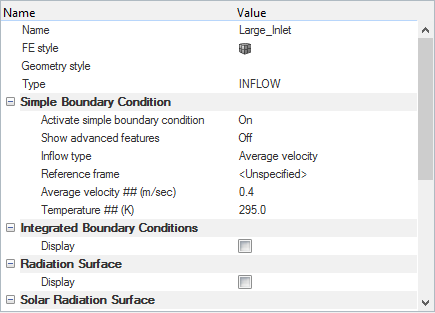

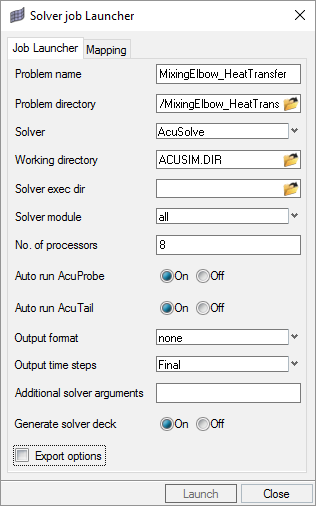

Compute the Solution
In this step, you will launch AcuSolve directly from HyperMesh and compute the solution.
Run AcuSolve

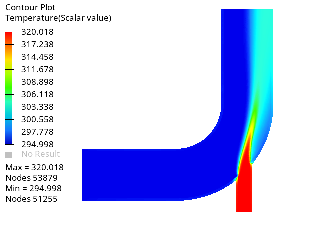

Post-Process the Results with HyperView
Open HyperView and Load the Model and Results

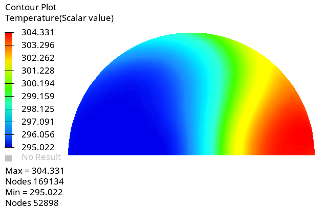

Create Contours for Temperature Distribution
