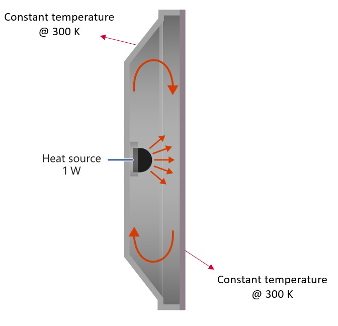

Problem Description

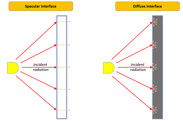

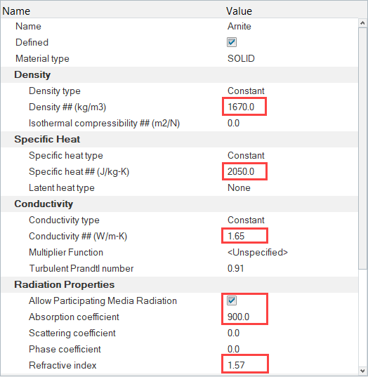

| Absorption Coefficient | Refractive Index | |
| Air | 0 | 1.0 |
| Lens | 900 | 1.57 |
| Surface Type | Radiation Surface Type |
| Participating medium - Participating medium Interface | Radiation Interface - Internal |
| Participating medium - (Non- Participating) medium Interface | Wall |
| External boundaries of Participating medium | Radiation Interface - External or Wall |

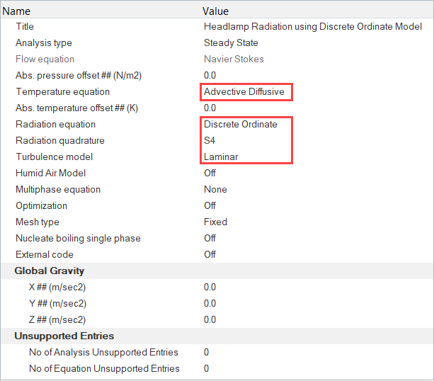

Set the Analysis Parameters

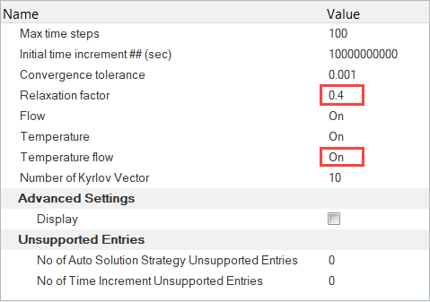

Specify the Solver Settings
Define the Material Models and the Body Force

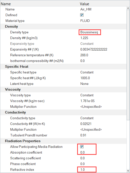

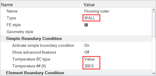

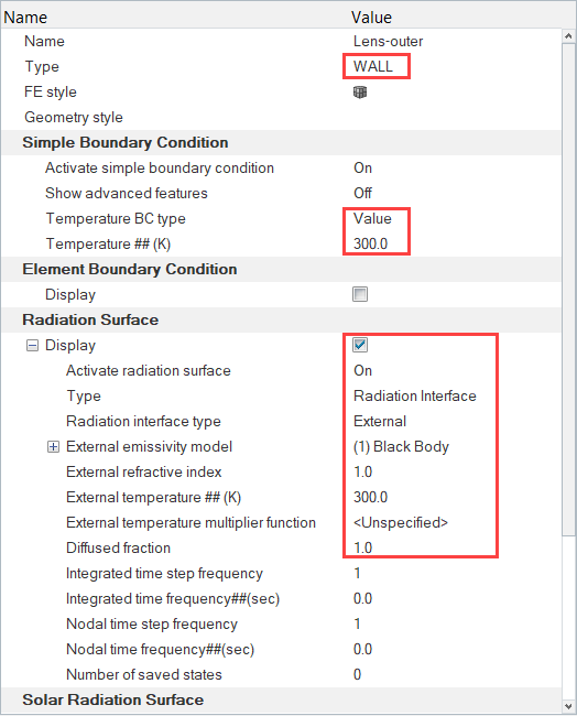

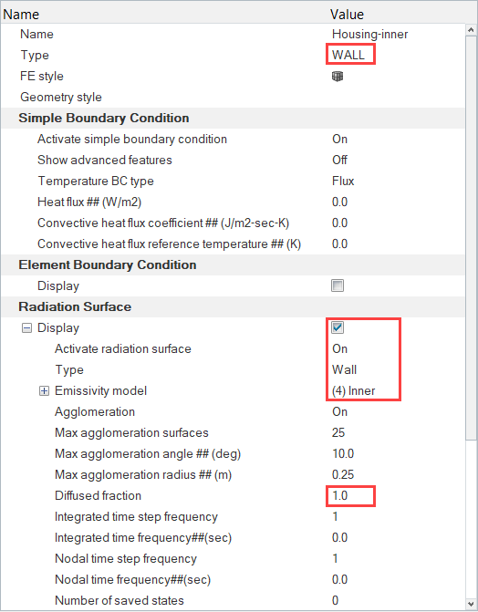

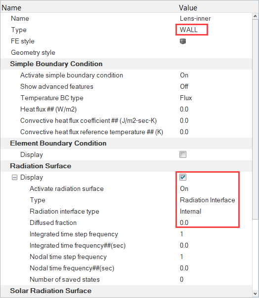

Set the Boundary Conditions
Create the Emissivity Model
- In the Solver Browser, right-click on 07.Emissivity_Model and select Create.
- In the Entity Editor, name it Inner.
- Set the Emissivity to 0.05.

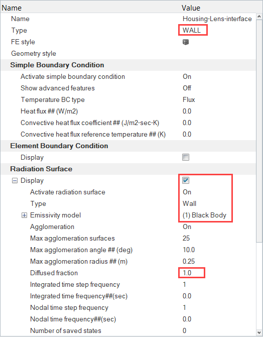

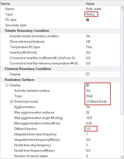

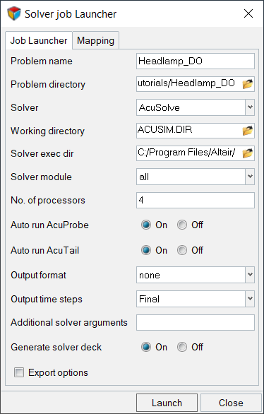

Run AcuSolve
In this step, you will launch AcuSolve to compute a solution for this case.

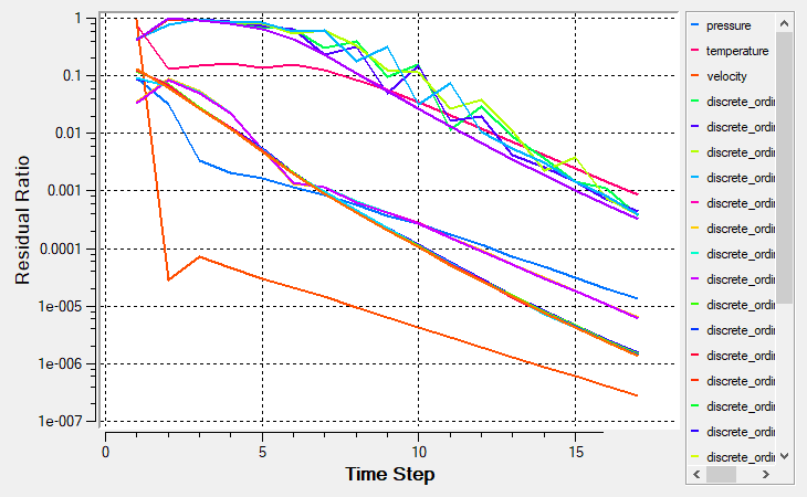

Monitor the Solution with AcuProbe
While AcuSolve is running, you can monitor the progress of the solution using AcuProbe and plot the values of residual ratios, solution ratios, and variables like temperature, heat flux, etc. Once the solver run has started, the AcuTail and AcuProbe windows should be launched automatically.

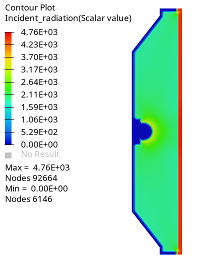

In this step, you will visualize the results using HyperView. While doing so, you will create contour plots of temperature and incident radiation on a section cut. Once the solver run is complete, close the AcuProbe and AcuTail windows. In the HyperMesh Desktop window, close the AcuSolve Control tab and save the model.
Switch to the HyperView Interface and Load the AcuSolve Model and Results

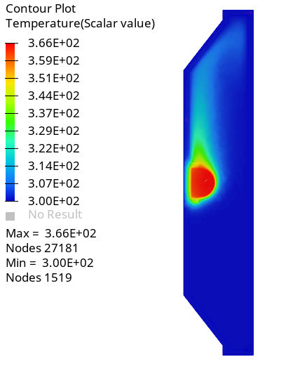

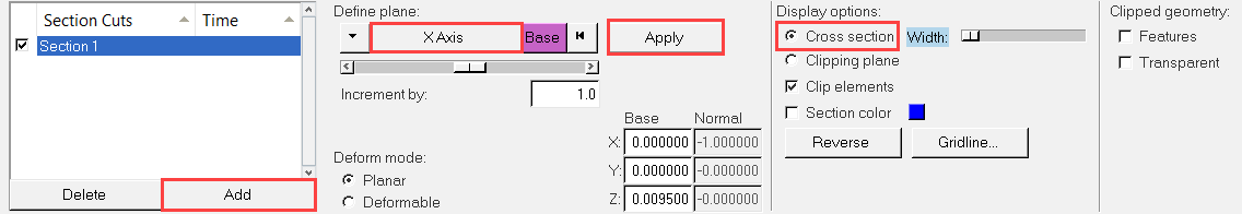

Create Temperature and Incident Radiation Contours on a Section Cut
