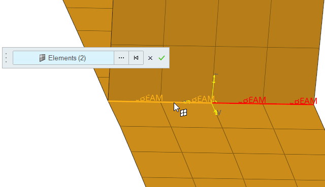

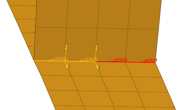

Divide
The Divide option is useful when you need to divide a continuous weld line into two or more pieces.

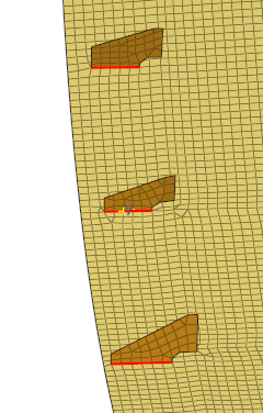

Divide Unconnected
The Divide Unconnected option is useful when HL-WC detects disconnected weld lines connecting the same set of components and defines these weld lines as a single weld line. The Divide Unconnected operation can automatically detect all discontinuous weld lines and break them up into separate weld lines.
