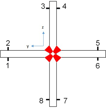

The weld line direction mainly defines the location of the evaluation points and the location of the weld line itself. For example, a T-weld could be connected from left to right or from right to left.
- The Y axis of the coordinate system points to the first evaluation point, and is perpendicular to the weld line.
- The Z axis, in case of T and L welds, points towards the web material.
- The X axis represents the direction of the weld line.
T, L, X, and M Welds
Figure 3.
Figure 4.
- The first node should be perpendicular to the weld line, and lie on the base material. This will be the Y axis of the coordinate system.
- The second node should lie on the weld line. This will be the origin of the coordinate system.
- The third node should also be perpendicular to the weld line and lie on the web material. This will be the Z axis of the coordinate system.

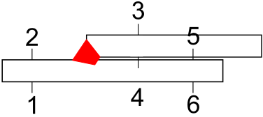

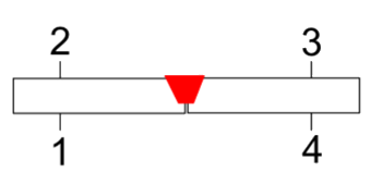

Butt and Overlap Welds
Figure 5.
Figure 6.
- The first node should be perpendicular to the weld line and lie on the first base material. This will be the Y axis of the coordinate system.
