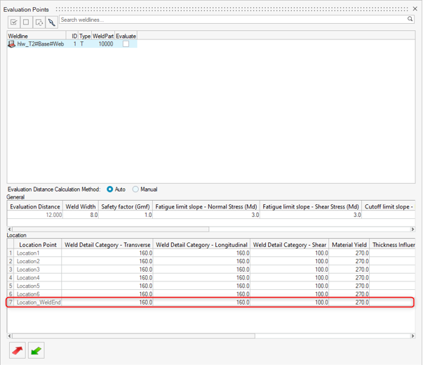

Click the Points tool.
Figure 1.The Evaluation Points dialog opens. - Select a weld line.
Select a method for calculating evaluation distance.
Option Description Auto Evaluation distance is calculated internally based on the evaluation distance(s) and weld width. Manual The tool uses the values you specify to identify the location. -
Edit the general parameters and the location parameters for the weld by
selecting options from the drop-down menus or entering values in the text
boxes.

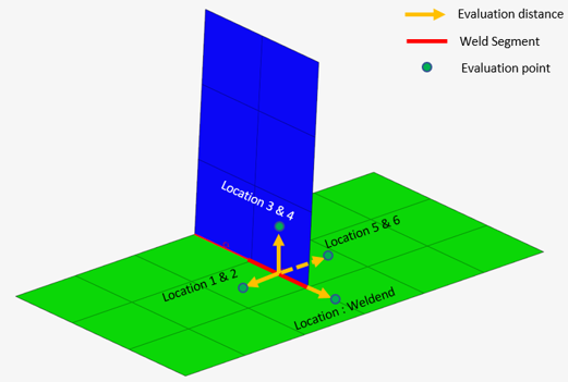

Note: The properties available in each table are updated according to the specification selected.Each point is defined at the evaluation distance specified in the General table and is measured from the weld segment centroid.
Figure 2. - Optional:

An additional evaluation point will be added for a weld end. Its evaluation distance will be measured from the free end of the weld segment. The weldend will be listed in the location table of points context and will be evaluated when the preference option Enable Weld End Evaluation is activated.
Figure 3.
