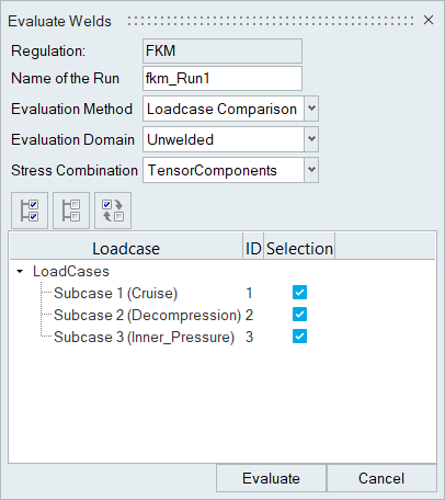

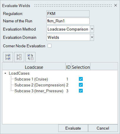

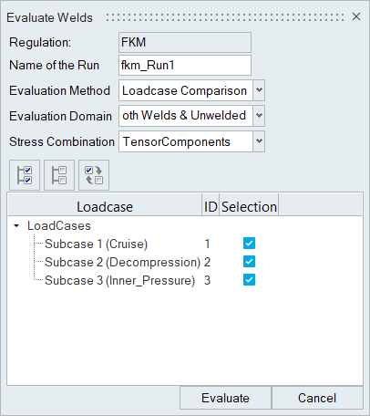

Select an evaluation domain.
Unwelded calculations can be evaluated along with welds or excluding them.Note: This option is only available if the selected specification is Eurocode 3 or FKM.
Figure 2. Welds Evaluation Domain
Figure 3. Unwelded Evaluation Domain
Figure 4. Both Welds & Unwelded Evaluation Domain -
Activate the Corner Node Evaluation option to compute
the results by querying stress from nodes.
Note: To use this option:
- Welds must be the evaluation domain. Unwelded domains are not supported.
- Corner data stresses must be present in the result file.
Corner data is the default evaluation method for welds detected between solid components.
If the evaluation domain includes unwelded components, choose a stress
combination.
Depending on the selected regulation, Stress Amplitude/Range will be created for the requested stress combination using the base tensor components.
