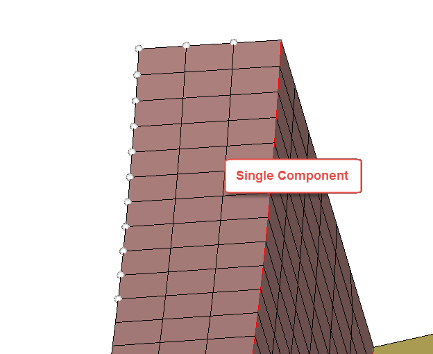

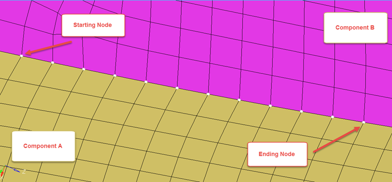

Select the nodes that represent the start and end of the weld line from the modeling window.
All the nodes located in between the starting and ending nodes will automatically be selected for the weld line.
The selected nodes need not connect two or more components. This feature supports the use case where you may be working on a model that is split at a weld line.
