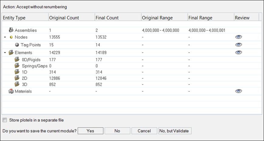

- Yes
- The root representation file is to be saved, in this case, intra and inter ID conflict flag will be set to Yes.
- No
- The root representation file is not to be saved, in this case, intra and inter ID conflict flag will be set to No.
- Cancel
- The exit Prepare Module Mode action is aborted.
- No, but VALIDATE
- In this case there is no change to the file and no need to save the file, but intra and inter ID conflict flag will be set to Yes.

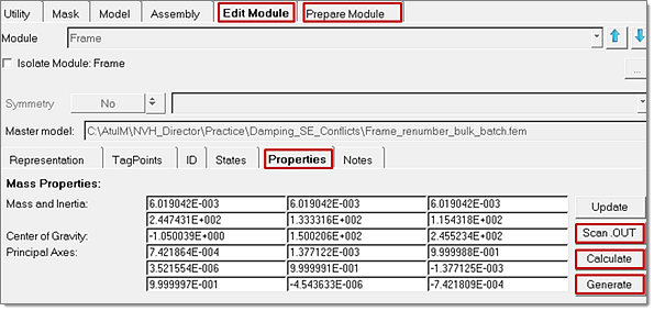

Mass Extraction Utility
- Extract module mass, moment of inertia and center of gravity information in prepare module mode.
- Automate the creation of rigid body representation for the module using the above information.
- Calculate the information by clicking Calculate. This will calculate the mass information necessary for rigid body representation of a module.
- Clicking Scan .OUT scans the information from the .OUT file. This will scan the mass information from the .OUT file generated using MASSPROP during the solver run.
