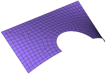

Import the model containing the new mesh in HyperMesh.

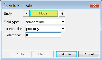

- In the Model Browser, right-click on the field entity and select Realize from the menu.
In the Field Realization dialog, define the realization
settings:
Figure 2.- With the Entity selector set to Node, select the nodes you would like to map.
- Set Field Type to temperature.
- Set Interpolation to proximity (finds the closest nodes) or linear (finds nodes using the inverse distance average).
- In the Tolerance field, type the perpendicular projection tolerance. Nodes outside of the 14.0 limit will not be mapped.
Click Apply.

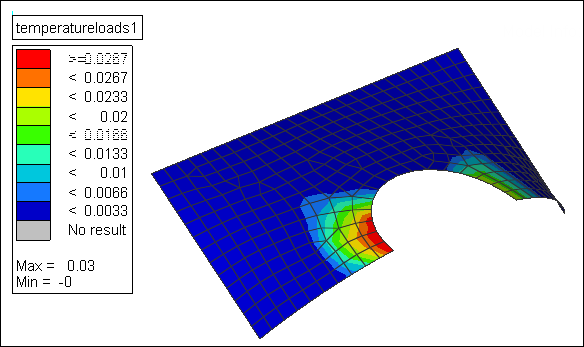

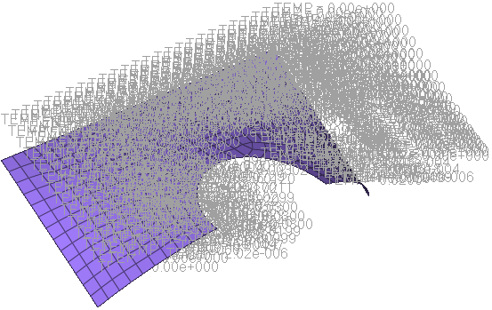

Temperatures from the .csv file are now mapped to the new mesh.
Figure 3. - Click Contour to see the mapping.
