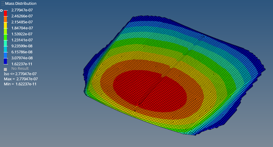

Solver masses are used to model lumped mass finite element mesh.

| *ELEMENT_MASS_PART | Define additional non-structural mass to be distributed by an area/volume or mass weighted distribution to all nodes of a given part. |
| *ELEMENT_MASS_PART_SET | Define additional non-structural mass to be distributed by an area/volume or mass weighted distribution to all nodes of parts referenced in a set. |
