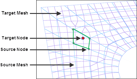

- Continuous fields evaluate data based on the shape function of source
mesh data and its nodal or elemental values. If the location of the
x,y,z points or u,v points are well structured in a rectangular array, a
source mesh can be constructed.Source data contains the mesh and the nodal or elemental values. The target mesh is different from the source mesh.

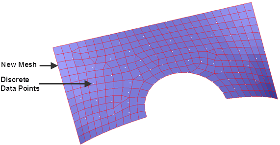

Figure 1. - Discrete fields provide data on discrete x,y,z locations (real) or u,v
locations (parametric), without the source mesh. Depending on the
fitness of the data points, the closest point approach or inverse
distance linear interpolation method will be used to map.

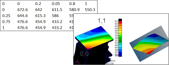

- Real coordinate systems (x,y,z values)
Figure 3. - Parametric systems (u,v tables)
Figure 4.

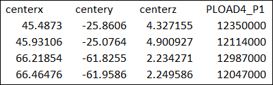

- CSV file: loads a .csv file containing x,y,z, value1, value2 discrete data.
