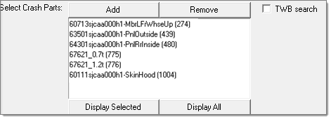

Select Components
- Add
- Select the components for intializing from the graphics area or by using the Selector panel.
- Remove
- Remove the selected components by selecting them from the graphics area or by using the Selector panel.
- Display Selected
- Isolate the selected components in the graphics area.
- Display All
- Display all components in the model.
The selected components appear in the Process Manager tab.
Selecting the checkbox for TWB search will prompt the software to check for Tailor Welded Blanks (TWB) among the selected blanks.
Clicking Proceed or Next moves you to the next step.

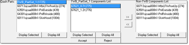

Review TWBs
Figure 3.
| TWB Components List | Lists the parts that are auto detected as TWB's for the selected TWB in crash parts. |
| Non-TWB Components List | Lists all other components that are selected by you for results initialization. These are potential components that can be added to the selected TWB. |
| Moves the selected component(s) from the TWB Components List to the Non-TWB Components List. | |
| Moves the selected component(s) from the Non-TWB Components List to the TWB Components List. | |
| Accept | Accepts the changes to the component list of the selected TWB. |
| Reject | Rejects the changes to the component list of the selected TWB. |
| Display Selected | Isolates the selected components in the graphics area. |
| Display All | Displays all of the components in the corresponding list. |

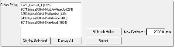

Fill Mesh Holes
Figure 4.
- Max Perimeter
- Maximum perimeter of the hole that needs to be filled.
- Fill Mesh Holes
- This option temporary fills the holes whose perimeter is less than the value specified in the selected components.
- Reject
- This is a one level undo operation on the hole fill in the selected components.

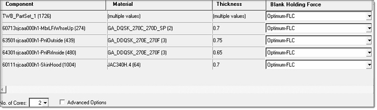

Solve and Initialize Components
Figure 5.
- No. of Cores
- Define the number of cores used in the initialization process. By default it is set to the number of cores in your desktop.
- Advanced Options
- Selecting this checkbox will add a new Bending/Unbending column to the table that lists all of the components. By default Bending/Unbending will be on for all components.
- Checking the selected components for undercuts
- Exporting the modeling
- Running the HyperForm One-Step solver and
- Importing the results
During this process, the Engineering Solutions session is live. Messages are continuously posted to update you with the status of the initialization process. At the end of this stage, the file that has the result for each selected component are attached as an include file to the model.

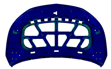

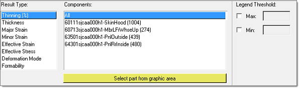

Review Results
Figure 6.
- Legend threshold option
- The Legend Threshold option allows you to set the maximum and minimum threshold value of the results legend and accordingly contour the results.

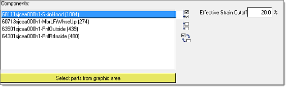

Apply Cutoff
Figure 8.
Click Initialize to rerun the analysis with the cutoff value for the selected components, as explained in the solve and initialize phase. The results from this rerun for the selected components will overwrite the results from the earlier run.

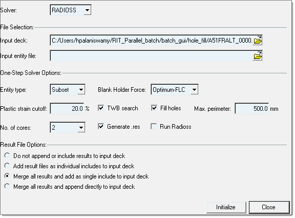

Batch Results Initializer
Figure 9.
- Solver
- This is a destination solver of the CAE analysis. Currently LS-DYNA and Radioss are supported. Based on the choice of the solver some of the options change.
- File Selection
- Input deck
- The solver deck that has components/ assemblies that need to be initialized with stamping results.
- Input entity file
- The initialize.dat file that has the components that need to be
initialized with stamping results. This is a text file with four columns with space as
a delimiter.
- Column 1
- Component Name. Ensure that no special characters are used.
- Column 2
- Component ID
- Column 3
- Type. It is limited to Part for LS-DYNA and Part and Subset for Radioss.
- Column 4
- Blank Holder Force. You can choose one of the following: Crash-form, None, Low, Medium, High, Optimum-FLC or Optimum-EPS.
- One-Step Solver Options
- Entity type
- You can choose Part for LS-DYNA and Part and Subset for Radioss. These settings will be used if column 3 in the initialize.dat file is blank/undefined.
- You can choose one of the following: Crash-form, None, Low, Medium, High, Optimum-FLC or Optimum-EPS. These settings will be used if column 4 in the initialize.dat file is blank/undefined.
- Plastic strain cutoff
- This is the max strain value beyond which strain from stamping will be saturated to this value. The value is provided in percentage. For example, a strain value of 0.2 should be provided as 20.
- TWB (Tailor Welded Blank) search
- If this is turned on, a search is performed within components selected for Results Initializer to have potential TWBs. The TWB components are then subjected to one step stamping analysis together.
- Fill holes
- If turned on, the holes on the component are filled and then subjected to one step stamping analysis together.
- Hole fill size
- This field is available only if the Fill holes option is turned on. Provide the maximum size (perimeter) of the hole that needs to be filled before one step stamping analysis.
- No. of cores
- You can define the number of cores available in your computer. By default it will use all the cores in your computer.
- Generate .res
- If turned on, a res file that has the results of all the components chosen for Results Initializer will be created at the end of run.
- Result File Options
- These options are self explanatory.
- Input files
- Solver deck that has components that need to be initialized with stamping results.
- Initialize.dat: The list of components in the solver deck that need to be initialized and corresponding stamping information.
- Output files
- LS-DYNA: Key file that has the stamping results from Results Initializer.
- Radioss: STA file that has the stamping results from Results Initializer.
