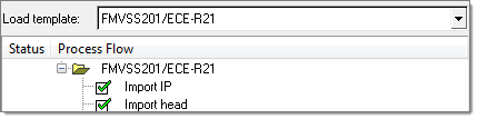

Invoking FMVSS 201/ECE-R21 opens a Process Manager tab that guides you through the process. You can go from one task to the next by clicking Next and Apply on the input panel.

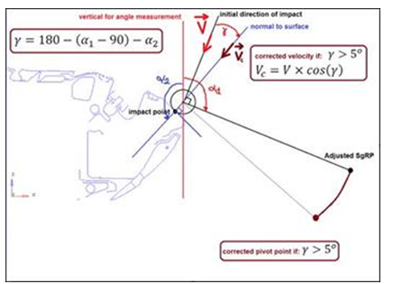

Figure 2. Nomenclature for the Angles Displayed in the Table for ECE-R21
Figure 3.
- Impact Angle
- Angle between the vertical axis and the direction of impact.
- α1
- Angle between the vertical axis, the pendulum arm set at the impact point, and adjusted SgRP.
- α2
- Angle between the vertical angle and the normal to the surface at the target point.

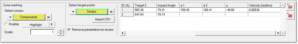

| Select comps | Select the components of the IP. |
| Enable | Turn zone marking on or off. |
| Highlight | Toggle between Highlight (default) and Show only modes of zones. |
| Scale | The scale factor for the standard impact zone. |
| Select pivot/target points | If the design team has performed the positioning and have generated pivot
points for the headform, you have the option to import the pivot point via a
.csv file. The headform pivot node is then positioned at
this location and rotated to make contact with the IP. If the pivot points are unknown, you can identify target points on the IP or import a .csv file with target points. The pivot point will be determined and the headform will be positioned. |
| Table | Specified target points are tabularized in the table which shows the target name, target coordinates, alpha and beta angles for each target point. Select the target points for review or export by clicking the respective checkboxes. If the alpha and beta angle is unknown, select the method to calculate the angles. |
| Deletes the row selected in the table. | |
| Deletes all rows in the table. | |
| Remove penetration for review | Removes penetration of the head into the IP during head positioning while reviewing points. |
