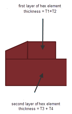

In the Solid Elems field, select an option that controls the number of solid
elements generated through thickness.
- Create solids for each layer – generate single solid elements for each input ply layer.
- Create single solids for all layers – generate single layered solid element through thickness. Output is either continuum shell of layered solid depending on the solver profile, element type setting (can be changed from 2D or 3D > elem types > 2D & 3D panel under penta6 and hexa8) and template property.
- Create multiple solids using dummy ply separation – generate multiple layered solid elements through thickness. The number of layered solid elements is determined by the number of “Dummy Plies” in the laminate. Output is either continuum shell or layered solid depending on the solver profile, element type setting (can be changed from 2D or 3D > elem types > 2D & 3D panel under penta6 and hexa8) and template property.

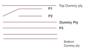

Create Multiple Solids Using Dummy Ply Separation
- Develop a composite shell model with Shell_section_composite property. Stop the procedure with ply realization. Do not convert the ply to a zone based model using laminate realize.
Change the 3D element type to SC8R and SC6R in the 3D subpanel on the Element
Types panel.
This will assign continuum shell properties to the newly created solids.

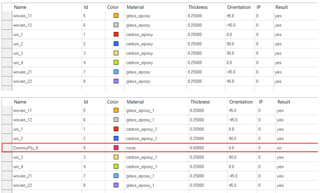

- Create dummy plies (zero thickness, zero ply angle) to separate the plies into a group. You are also required to create top and bottom dummy plies in addition to the separation dummy plies. Dummy plies can be created using the Edit Ply dialog and assigning all the elements in the model to that dummy ply so that it runs through the entire model.
- Next, the dummy plies need to be assigned to the laminate. It is required to add top and bottom dummy plies in addition to inserting separation dummy plies. This is accomplished using the Edit Laminate dialog.
- Select Shell To Solid Conversion from the Aerospace menu to open the Shell to Solid Conversion dialog. For Solid Elems select Create multiple solids using dummy ply separation. The Fill gaps checkbox is automatically selected as long as you define the top and bottom extra dummy plies in the laminate in addition to the separation dummy plies.

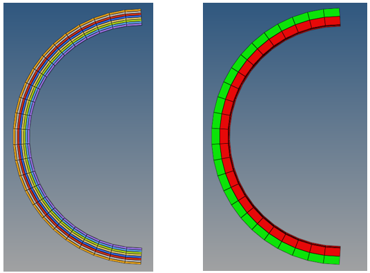

Select the laminate that is required to be converted and then click
Convert.
