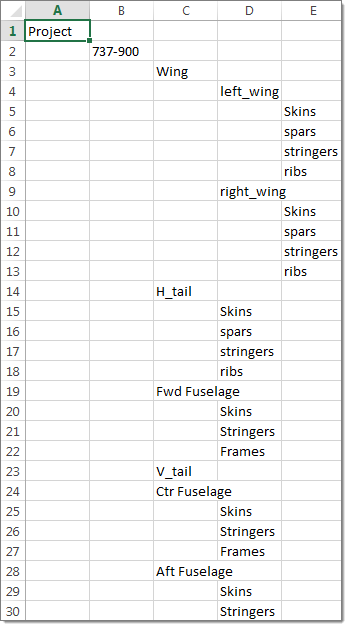

Create an assembly structure from a .csv file definition.
Figure 1. A .csv File Format for the Product Structure Definition

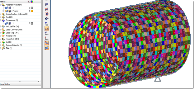

Figure 2. A Product Structure is Created in the Model Browser

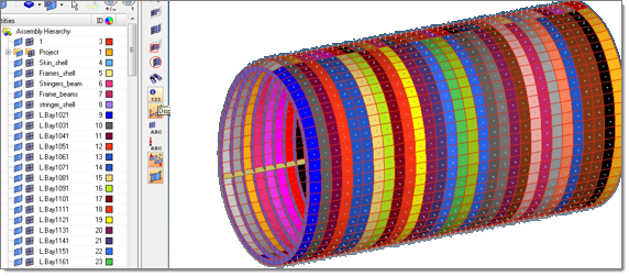

Figure 3. A Single Component Model- Click .

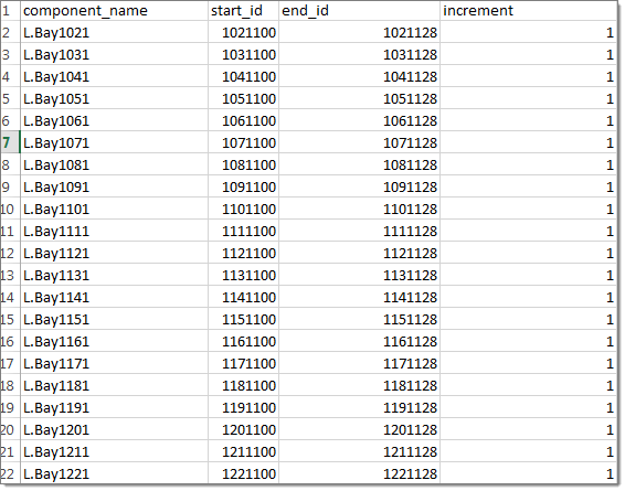

Figure 4. The Model is Split into Components using the Local System Direction

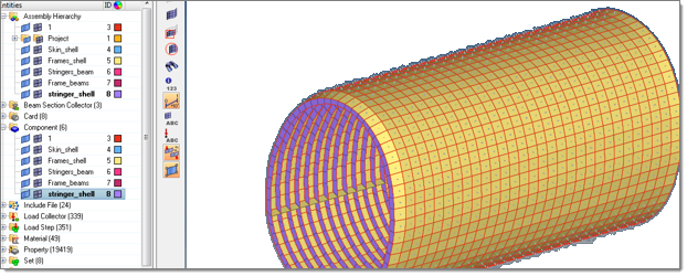

- Aerospace users typically assign ID ranges to specific components. Using
these definitions from a .csv file, the elements
are automatically separated into component names defined in the
.csv file.
Figure 5. ID Range .csv File with Component Names

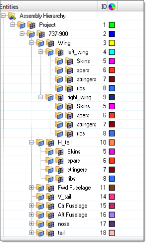

Figure 6. Based on ID Ranges, Elements are Separated into Components
