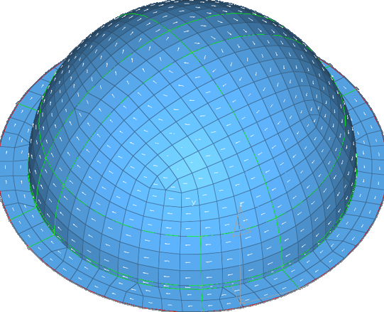

By Curve
- Select the elements for which a new material angle will be assigned.
- Select the lines or list of nodes to define the material direction. The
element centroid will be taken and projected to the closest line/node
segments and the line tangent direction will be found to assign the material
angle.

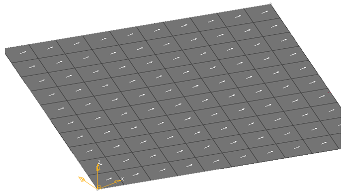

Figure 1. A Circular Pattern of the Material Orientation is Assigned Based on the Outer Circular Line Direction
Other material orientation tools are also available.

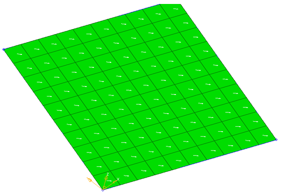

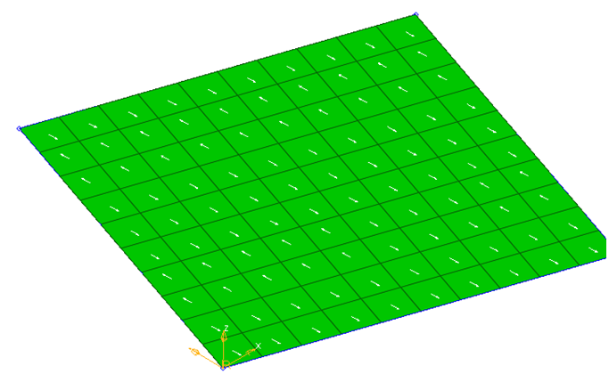

Figure 2. Two Nodes are Selected for Material Direction
Figure 3. Material Direction in the Same Direction as two Nodes

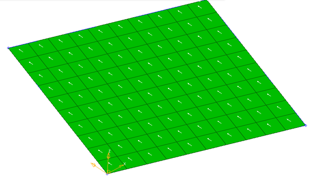

By System ID
Figure 4. X Axis of the System is used for Projection

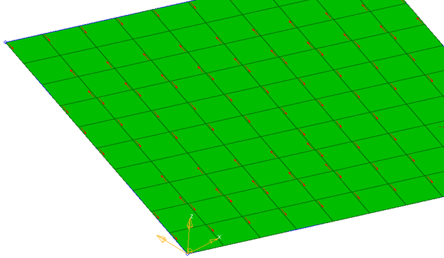

By System Axis
Figure 5. System Local Axis 2 is Projected to Create Material System
By Angle
Figure 6. Element N1-N2 Direction
Figure 7. Material System is Created at an Angle to N1/N2 Direction
