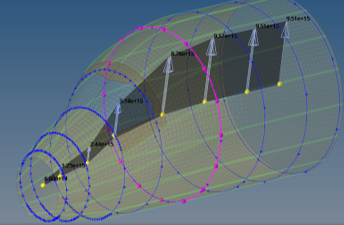

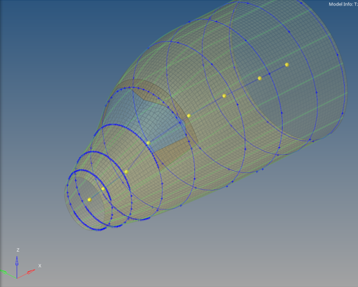

Expected Results
In the example below a fuselage is cut using eight nodes sampled along the x axis. Beam elements were created at centroid (in a new component) and beamsections where generated while keeping lines. The result after clicking Apply is shown in the image below.
Figure 1. . Section cuts and beam created
Figure 2. . Review sectional properties
