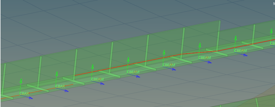

Figure 1. . The raw position of neutral axis and discrepancies between CBAR and CBEAM.

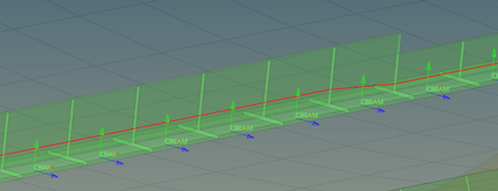

Figure 2. . Considering offset, neutral axis is continuous along the path. The tapered beam is also captured.

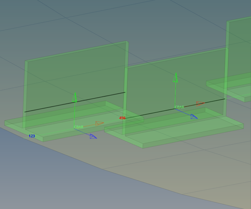

Figure 3. . Shear center position with offset value. Usually offset is not seen while 1D are in traditional representation.

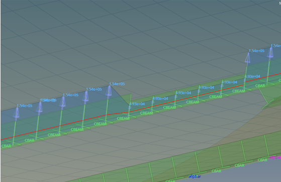

Figure 4. . Display Moment of Inertia Izz along a path of elements.

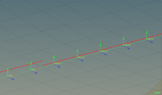

Figure 5. . Released degree of freedom on both ends (only first element is released). The second element has no offset applied.
