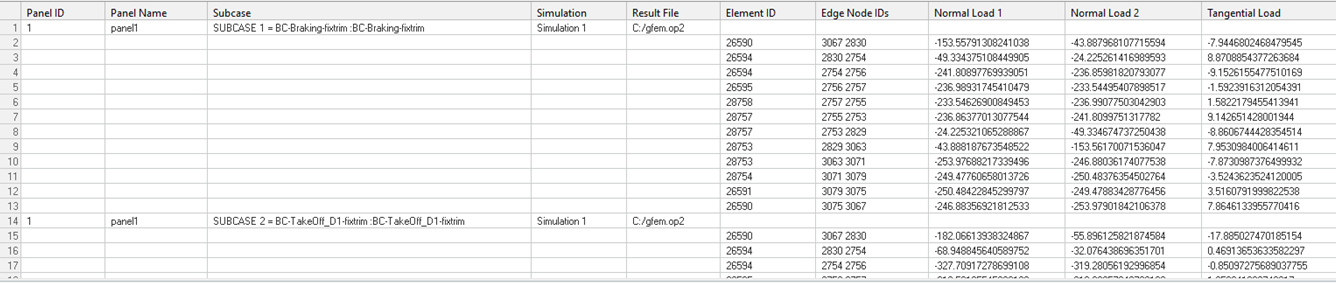

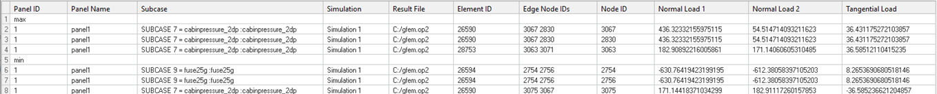

- Tables
- Creates tables with normal and tangential loads for one or multiple panels and for one or multiple loadcases.
