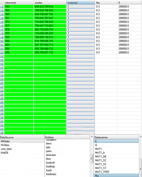

Access HyperMesh Data Using the Matrix Browser

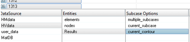

Access HyperView Results From the HyperMesh Database

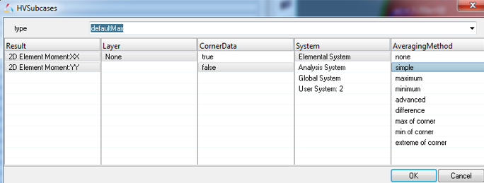

Access HyperView Results From the HyperMesh Database with Multiple Subcases
Access HyperView Results From the HyperMesh Database with the Current Subcase
Access HyperView Results From the HyperMesh Database with the Current Contour Results

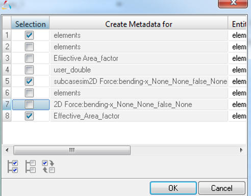

Create and Retrieve User Data in the Matrix Browser

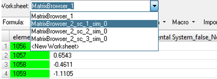

Work with Microsoft Excel

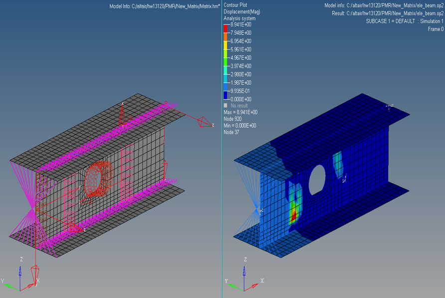

Display Data in HyperMesh or HyperView
Display data in HyperMesh.
Display data in HyperView.
