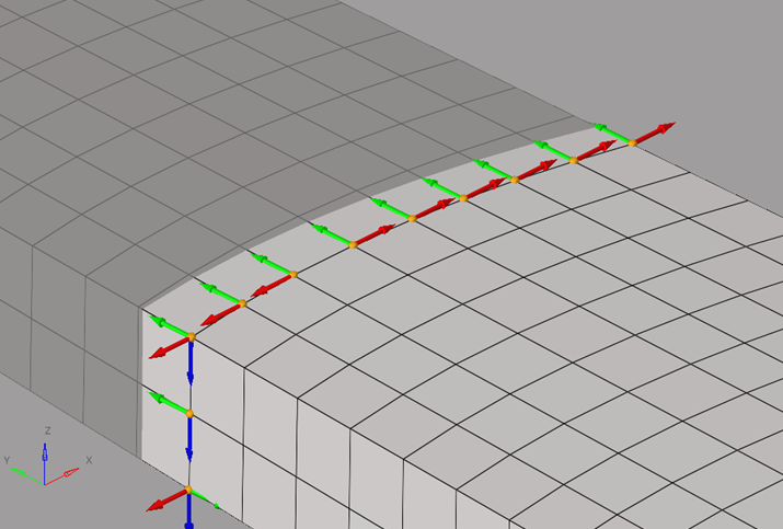

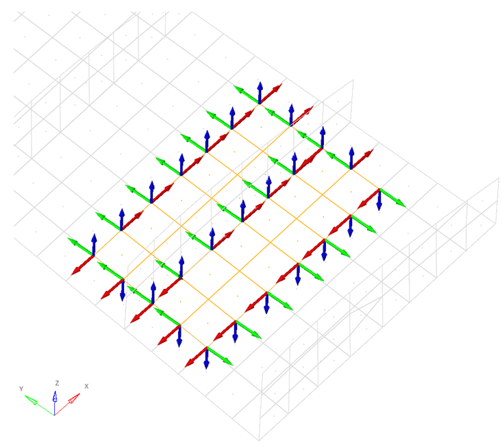

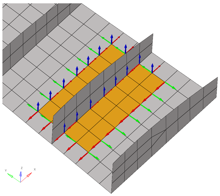

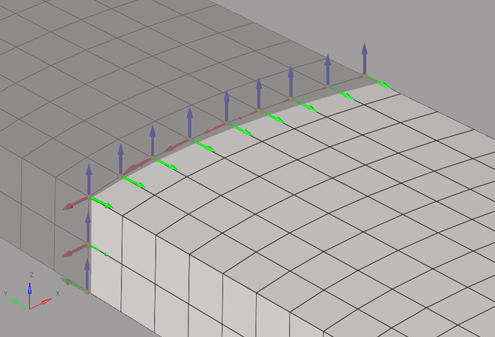

- Free body forces/moments
- Defines whether free-body forces and moments must be shown at each boundary
node or at all nodes. If the section group is made up only by elements and
the node ID list is empty, the boundary nodes option searches for all of the
nodes that are shared with the rest of the model.
Figure 1. All Nodes Option
Figure 2. Boundary Nodes
Figure 3. Boundary Nodes - Resultant forces/moments

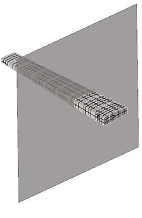

- Cross Section Position
- Moves the cross-section plane along its normal direction within the boundaries of the model. If the cross-section is realized, this option will not be available.
- Flip
- Allows you to select nodes that are on the opposite side of the
cross-section’s plane normal. If the cross-section is realized, this option
Figure 4.
Figure 5.

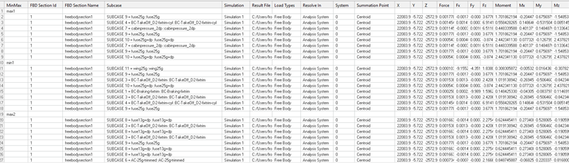

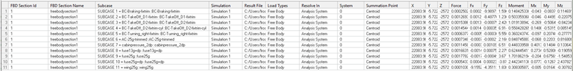

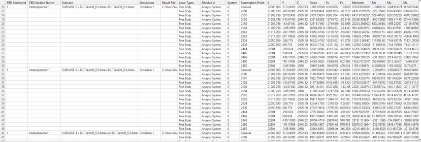

Figure 6. - Tables
- Creates tables with free-body forces and moments for one or multiple sections and for one or multiple loadcases. The summary table (and summary table summation points) can be used to create Potato/VMT plots.
