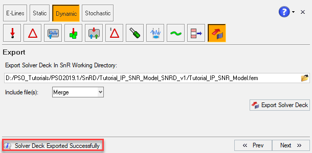

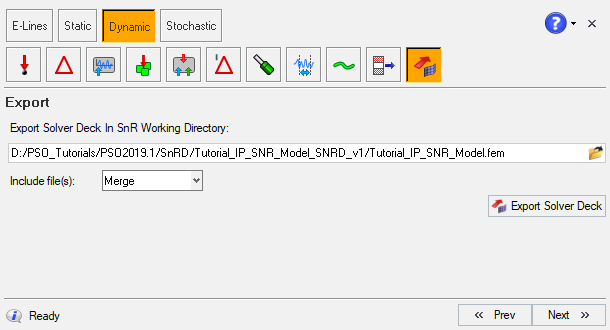

This is the final step in the pre-processing stage of building models for squeak and rattle analysis. In this step you can export the fully defined solver deck for solving. The panel for this step is shown in the below image.
Modal Analysis Setup - In case you want to perform Sensitivity Analysis of the results in the post-processing module of SnRD, a Modal Subcase is required in the model for the extraction of data, such as the modal contribution, which can then be used in the post-processing of results for a full Sensitivity Analysis.
SnRD now supports automated creation of the subcases required for performing a Modal Analysis.
This option will enable the creation of the necessary Modal Subcase in the solver deck, as an additional load case. Instead of manually creating this new subcase, SnRD uses the appropriate cards from the input in the Modal Transient Load case step and creates the Modal Subcase. The tool also ensures that the two subcases are properly combined.
