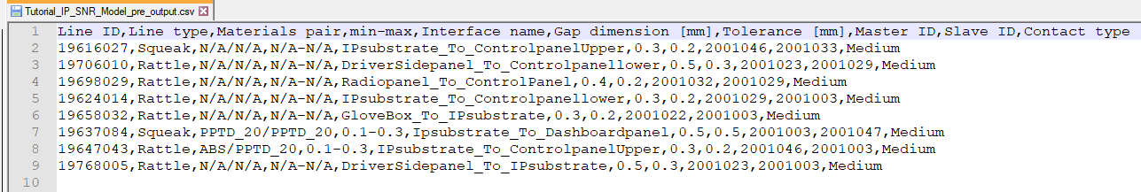

pre_output will be appended to the name. A sample file is shown
below:
