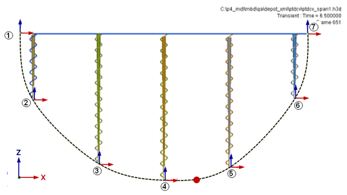

Example 1
The following example demonstrates the use of the Constraint_PTdCV element, along with the Reference_DeformCurve and Post_Graphic elements.
Figure 1. Using a Reference_DeformCurve to define a Constraint_PTdCV element
Figure 1 shows five slender bar-shaped rigid bodies constrained to a ground body, represented by the blue horizontal bar graphic, by translational joints with axes along the Z-direction. The bodies are connected to ground by linear spring-dampers. A deformable curve is defined to pass through seven markers (1-7 shown in the figure). Five of these markers, 2-6, are located at the lower tips of the rigid bodies. Two of these markers, 1 and 7, are located at either end of the ground body.
The curve is open, so is_u_closed is not specified, that is, it defaults to FALSE. The deformable curve, shown as a black dashed curve in Figure 1 is defined using the Reference_DeformCurve element as follows:
<Reference_DeformCurve
id = "1"
end_type_left = "NATURAL"
end_type_right = "NATURAL"
num_marker_id = "7">
1 2 3 4 5 6 7
</Reference_DeformCurve>
The curve can be displayed in a post-processor such as HyperView by using a Post_Graphic element as shown below. In this example, 100 segments are used to approximate the cubic spline in the display window.
<Post_Graphic
id = "500000"
type = "DeformCurve"
curve_id = "1"
nseg = "100"
A small spherical body, shown as a red sphere, is constrained to slide along the deformable curve. This constraint is described by a Constraint_PTdCV as follows:
<Constraint_PTdCV
id = "1"
i_marker_id = "30107060"
ref_dcurve_id = "1"
The red sphere is given an initial velocity that causes it to slide on the deformable curve. As the sphere slides along the curve, the weight of the red sphere causes varying amounts of deflection to occur in each in each of the springs. The curve changes its shapes as a consequence. A dynamic analysis of this system will show the changing shape of the deformable curve, as the sphere slides back and forth because of gravity.

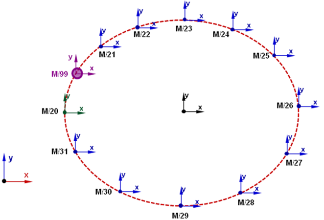

Example 2
This example demonstrates the use of the Constraint_PTdCV element for a closed curve, along with the Reference_DeformCurve and Post_Graphic elements.
Figure 2. Defining a Closed, Deformable Parametric Curve
Referring to Figure 2 above, the closed curve is an elliptical shape that is defined by the origins of markers 20-31. Markers 20-31 belong to different bodies. Thus, their motion is governed by the motion of their underlying bodies. The MotionSolve input for this curve is shown below. Notice that since the curve is closed, the first and last markers in the markers list are the same. This is emphasized by highlighting in red below.
id = "301"
label = "DeformableCurve 1"
u_span = "1."
is_u_closed = "TRUE"
num_marker_id = "13">
20 21 22 23 24 25 26 27 28 29 30 31 20
- { x(-0.5) y(-0.5) z(-0.5) } = { x(0.5) y(0.5) z(0.5) }.
- { x''(-0.5) y''(-0.5) z''(-0.5) } = { x''(0.5) y''(0.5) z''(0.5) }
A small spherical body, shown as a purple sphere in Figure 2 is constrained to slide along the deformable curve. The center-of-mass of the sphere is defined by Marker 99. This constraint is described by a Constraint_PTdCV as follows:
<Constraint_PTdCV
id = "1"
label = "Advanced Joint 0"
i_marker_id = "99"
ref_dcurve_id = "301"
An initial velocity, vo, starts the sliding motion of the purple spherical body. Over time, because the bodies containing markers 20-31 can move in their own way, the initially circular shape will become non-circular.
The curve shape can be displayed in a post-processor such as HyperView by using a Post_Graphic element as shown below. In this example, 150 segments are used to approximate the curve shape in the display window.
<Post_Graphic
id = "2"
curve_id = "30"
nseg = "150"

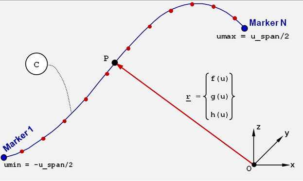

- Reference_DeformCurve is quite similar to
Reference_ParamCurve, except it can deform. The shape of the curve is
defined by the cubic spline that passes through the instantaneous origins of a set of
markers, shown in Figure 3 below
with brick-red spheres. Reference_DeformCurve is therefore a
parametric, deformable curve in 3D space. u is a free curve parameter that defines the
extent of the curve. It can vary from umin = - u_span/2
to umax = + u_span/2. Referring to Figure 3, the coordinates of any arbitrary P point on the curve, as measured in OXYZ, can be represented uniquely in terms of the free parameter u with three cubic-spline functions f(u), g(u) and h(u) that define the x-, y- and z-coordinates of P.
Figure 3. The Definition of a Reference_DeformCurve - Reference_DeformCurve can be opened or
closed. A closed curve has the property:
- { x(umin) y(umin) z(umin) } = { x(umax) y(umax) z(umax) }

range. Note: If you see such a message in your simulation, please check the results carefully as they may be wrong, even though the simulation completes successfully.There are, however, modeling changes that you can make to minimize the occurrence of such a condition. Referring to Figure 3, one approach to handle this condition is to define two impact forces:
- Between marker P and marker 1
- Between marker P and marker N
When P tries to go beyond the limits specified for u, an impact force that pushes the marker P into the allowable range is generated.
