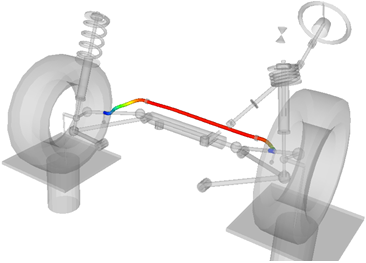

The following example shows how an NLFE body can be used to model a stabilizer bar used in the front suspension of an automobile.
Figure 2. NLFE Body Used to Create a Stabilizer Bar Flexible Part
The NLFE body is represented in MotionSolve by the Body_Flexible statement:
<Body_Flexible
id = "30601"
label = "Stabilizer Bar"
ref_marker_id = "30101010"
ancf_file = "stabar_NLFE_30601.xml"
rayleigh_damping = "0.5"
num_i_marker = "4">
30601011 30601191 30601091 30601111
</Body_Flexible>
Markers 30601011, 30601191, 30601091 and 30601111 are used to attach the NLFE system to the rest of the vehicle. Marker 30101010 is a ground reference marker located at the origin.
The NLFE body is defined in the file stabar_NLFE_30601.xml as follows:
<ANCF Model>
<UNIT force="NEWTON" mass="KILOGRAM" length="MILLIMETER" time="SECOND"/>
<GRID id="306001" x="1120.000000" y="-544.000000" z="989.000000" rx="0.000000 1.000000 0.000000" ry="-1.000000 0.000000 0.000000" rz="0.000000 -0.000000 1.000000"/>
<GRID id="306002" x="1120.000000" y="-515.000000" z="989.000000" rx="0.948371 -0.279089 -0.150668" ry="0.282312 0.959323 -0.000000" rz=0.144539 -0.042535 0.988584"/>
<GRID id="306018" x="1120.000000" y="515.000000" z="989.000000" rx="-0.286957 0.956858 0.045589 ry="-0.957854 -0.287255 -0.000000 rz="0.013096 -0.043667 0.998960"/>
<GRID id="306019" x="1120.000000" y="544.000000" z="989.000000" rx="0.000000 1.000000 0.000000" ry="-1.000000 0.000000 0.000000" rz="0.000000 -0.000000 1.000000"/>
<BEAMC id="20000" pid="10000" g1="306001" g2="306002"/>
<BEAMC id="20017" pid="10000" g1="306018" g2="306019"/>
<PBEAMC id="10000" mid="3000000" ri1="0.000000" ro1="10.000000" ri2="0.000000" ro2="10.000000" nf-"1" nx="5" nr="4" nt="10" ngx="5" ngr="4" ngt="12"/>
<MAT1 id="3000000" e="210000" nu="0.3" rho="7.86e-006"/>
</ANCFModel>
As can be seen from the file above, the stabilizer bar is defined by BEAM elements of a circular cross section. The NLFE body refers to a linear elastic material.
