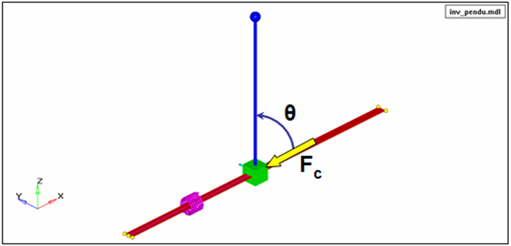

Example
Figure 1. Inverted Pendulum Model
- Plant input: Control force Fc acting on slider along global X.
- Plant output: Pendulum angle θ.
The plant output may be defined as follows:
<Control_PlantOutput
id = "303001"
num_element = "1"
variable_id_list = "12"
hold_order = "1"
Reference_Variable 12 defines the pendulum angle θ.
