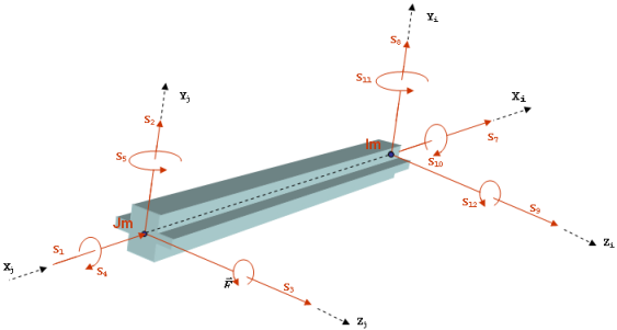

Figure 1 shows the definitions associated with a Force_Beam element.
- The x-axis of the J_Reference_Marker defines the neutral axis of the beam. The y- and z-axes of the J_Reference_Marker define the principal axes of the cross section. In other words, those directions along which the products of inertia Iyz = 0.
- At zero deformation, the
I_Reference_Marker is offset along the x-axis of
J_Reference_Marker by a distance equal to the free
length of the beam. It has the same orientation as
J_Reference_Marker.
The following forces act on the beam.
- Axial forces S1 and S7.
- Shear forces S2, S3, S8 and S9.
- Bending moments S5, S6, S11 and S12.
- Twisting moments S4 and S10.
Figure 1. The definition of Force_Beam - The three angular deflections, AX(I,J), AY(I,J) and AZ(I,J) must remain small at all times. The angles AX(), AY() and AZ() lose physical significance otherwise, and the beam theory is no longer valid. Small means < 10 degrees.

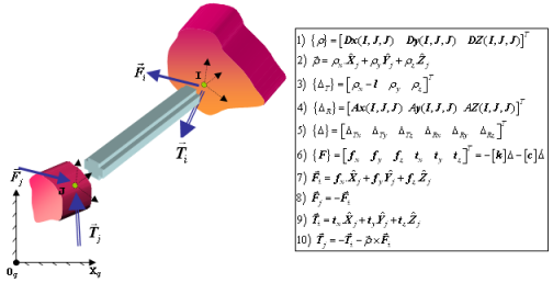

- Figure 2
shows an exploded view of a Force_Beam acting between
two bodies. The exploded view is used to explain the implementation details
of a Force_Beam.
- Equations 1-4 show how the deformations are calculated.
- Equations 5-6 defines the force implementation.
- The last four equations, 7-10, show the forces and torques generated by the Force_Beam element are applied to the two bodies.
Figure 2. Implementation of a Force_Beam - When the cross section of the beam is not
