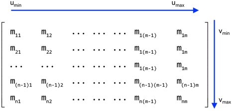

Dsurface (markers=objMatrix, optional_attributes)Attributes
- markers
- Matrix of Marker objects
- id
- Integer
- label
- String
- end_type
- String
- u_span
- Double
- v_span
- Double
- u_closed
- A Boolean value (True or False) that determines whether the markers that define the curves are closed in u or not.
- v_closed
- A Boolean value (True or False) that determines whether the markers that define the curves are closed in v or not.
