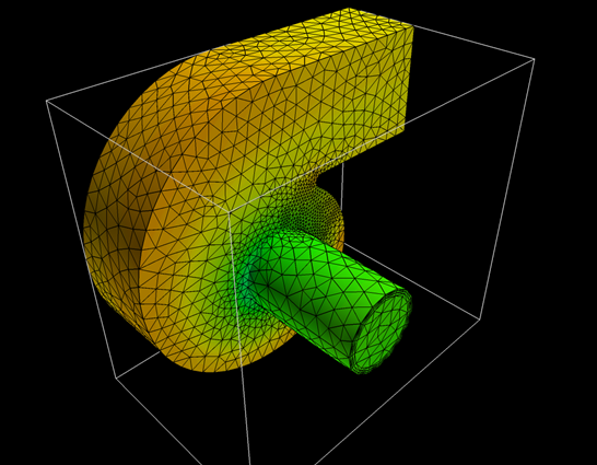

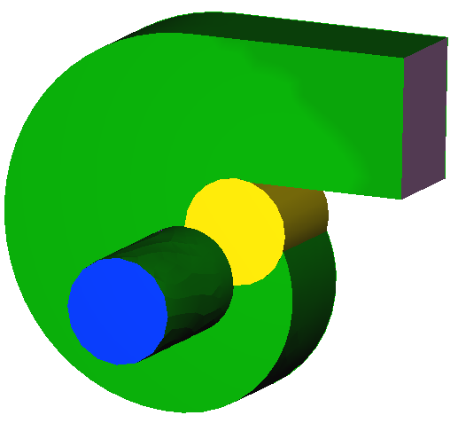

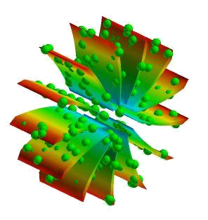

The problem to be addressed in this tutorial is shown schematically in Figure 1 and Figure 2. It consists of a centrifugal blower with backward curved blades.
Figure 1. Schematic of Centrifugal Blower
Figure 2. Schematic of Fan Blades
To capture the dynamic motion of the impeller blades, the simulation has to be run as transient. The converged steady state solution from the steady blower simulation is projected on the mesh and used as the initial state for the transient simulation.
The simulation will be run to model 0.12 s of the flow, which would constitute three revolutions of the fan blades with time step sizes scaled using a multiplier function.

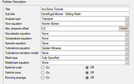

Set General Simulation Parameters
In next steps you will set parameters that apply globally to the simulation. To make this simple, the basic settings applicable for any simulation can be filtered using the BAS filter in the Data Tree Manager. This filter enables display of only a small subset of the available items in the Data Tree and makes navigation of the entries easier.
The general parameters that you will set for this tutorial are for turbulent flow, transient analysis, and mesh type as fully specified, which means that the motion is fully specified at the beginning of each time step and hence no mesh equation needs to be solved.

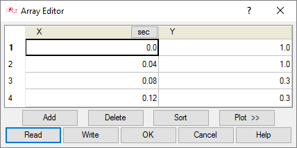

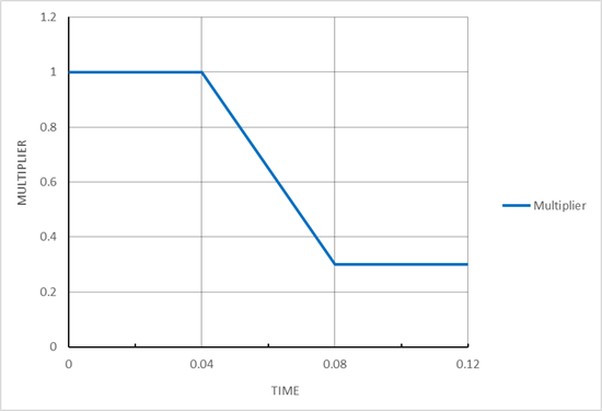

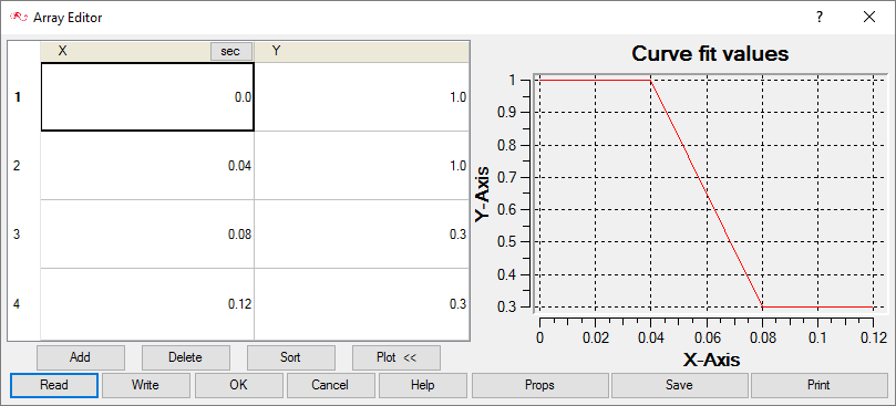

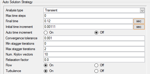

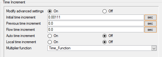

Create a Multiplier Function for the Time Increment

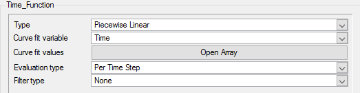

AcuSolve provides the ability to scale values as a function of time and/or time step during a simulation. This is achieved through the use of a multiplier function. In this tutorial, the time steps sizes are scaled against time to set up a robust solution.
In the next steps you will create a multiplier function for the time increment. The multiplier function is chosen such that the impeller blades rotate at 10 degrees per time step for the first revolution (0 s– 0.04 s), then ramp down from 10 degrees per time step to 3 degrees per time step during the second revolution (0.04 s – 0.08 s) and complete the third revolution at 3 degrees per time step (0.08 s – .12 s)
To make the creation of the multiplier functions as simple as possible, you will use the PB* filter in the Data Tree Manager.
Modify the Advanced Solution Strategy Parameters
AcuSolve provides additional features to modify some advanced solution strategy attributes separately, such as individual staggers (flow, mesh, turbulence, and so on), time increments, linear solver parameters and many more. In this tutorial the time increment feature is turned on in order to scale the time step sizes based on a multiplier function.
In the next steps you will work with the time increment feature under advanced solution strategy to assign the multiplier function.

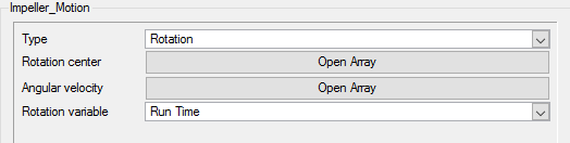

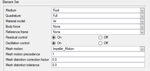

Create the Mesh Motion
This command is used to simplify the specification of boundary conditions on mesh displacement and it can be used to simulate the dynamic motion of a rigid body. In this tutorial, the fluid region near the impeller blades is assigned a rotating mesh motion. The parameters defined for this would be the angular speed of the impeller blades and the center of rotation of the motion.
In the next steps you will create a mesh motion.

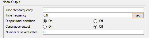

Set the Nodal Output Frequency
The Nodal Output Frequency determines at what frequency or time interval the solution results would be stored to be used for post processing within AcuFieldView.

Volume groups are containers used for storing information about a volume region. This information includes solution and meshing parameters applied to the volume and the geometric regions that these settings are applied to.

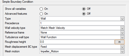

Modify Parameters for the Fan Blades
In the next steps you will specify the mesh motion associated with fan blades.

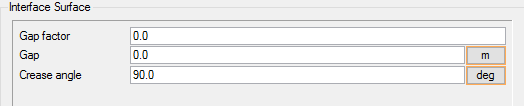

Modify Parameters for the Interface
In the next steps you will assign Interface Surface properties to the Interface.

Activate Interface Surface for Interface.

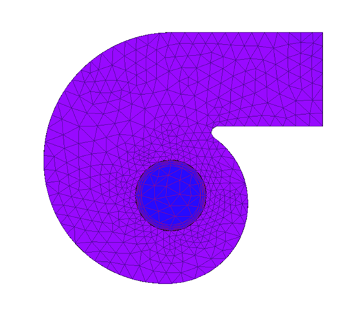

Set Zone Meshing Attributes

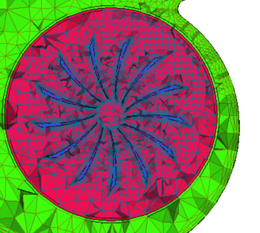

In addition to setting meshing characteristics for the whole problem, you can assign meshing attributes to a zone within the problem where you want to be able to resolve flow with a mesh that is more refined than the global mesh. A zone mesh refinement can be created using basic shapes to control the mesh size within that shape. These types of mesh refinement are used when refinement is needed in an area that does not correspond to a geometric item.
In the following steps you will add mesh refinement in the zone around the impeller blades closest to the housing wall as shown in figure 3.

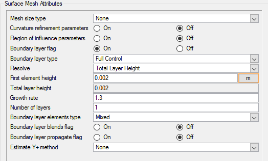

Set Surface Meshing Parameters for the Interface
In the following steps you will set meshing attributes that will allow for localized control of the mesh size near on the interface.

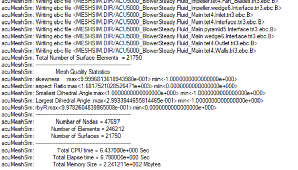

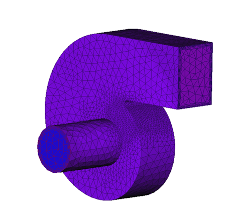

Generate the Mesh
In the next steps you will generate the mesh that will be used when computing a solution for the problem.

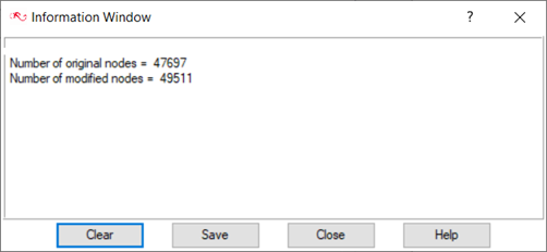

Split the Nodes on the Interface
At this point, the interface surface has one set of nodes which are either attached to the Fluid_Main or Fluid_Impeller volume sets. In order for the nodes inside the Fluid_Impeller volume and Interface to rotate based on the mesh motion prescribed, a duplicate set of nodes needs to be created, so that one set of the nodes follow the motion of the Fluid_Impeller and another set stays attached to Fluid_Main.
Splitting the nodes on the interface would allow the nodes attached to Fluid_Impeller to slide over the nodes on Fluid_Main, hence simulating the rotation on the fluid domain with the impeller blades.
In the next steps you will split the nodes on the interface using the Mesh Op. tool.

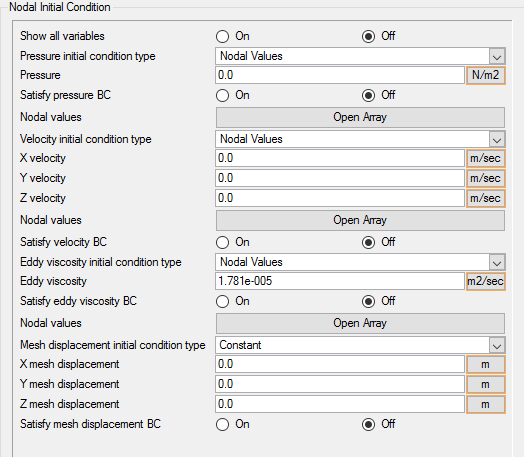

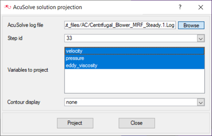

Project Steady State Solution to Use as Initial Conditions
In the next steps you will use the Project Solution to project the steady state solution onto the transient case in form on Nodal Initial Conditions.

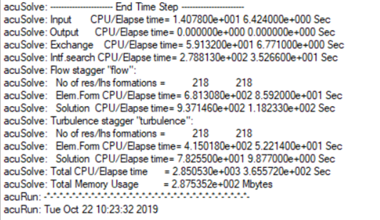

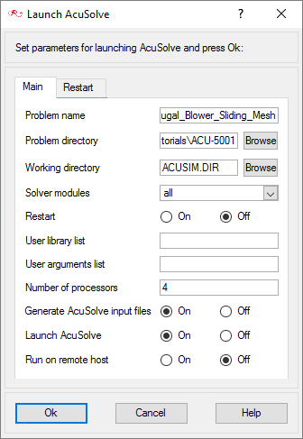

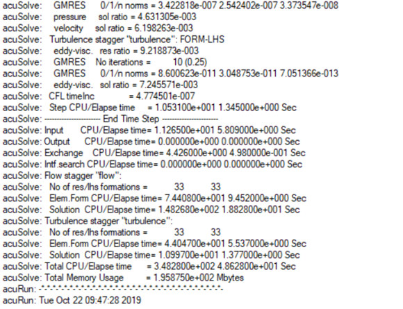

Run AcuSolve
In the next steps you will launch AcuSolve to compute the solution for this case.

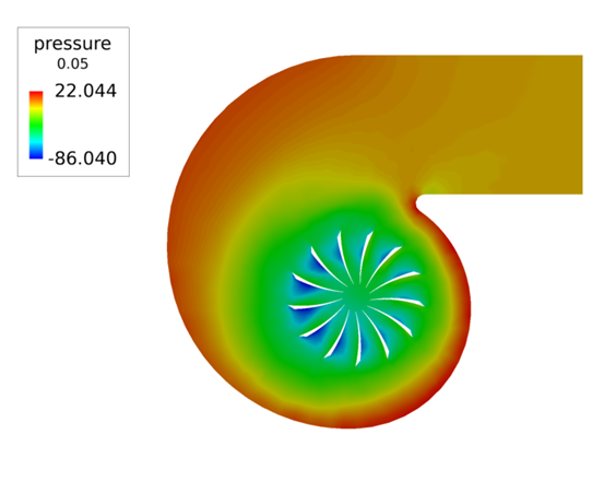

In the following steps you will start AcuFieldView, display the pressure contours on the mid coordinate surface and generate animations for pressure, streamlines and particle paths.
Start AcuFieldView

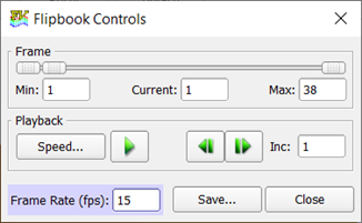

Animate the Pressure Contours on the Mid Coordinate Surface

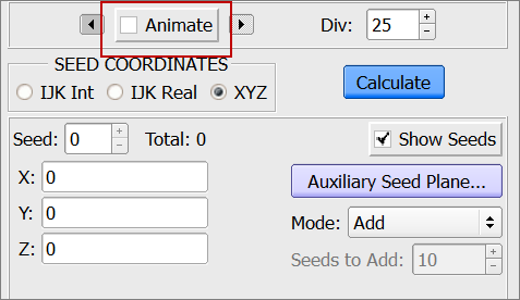

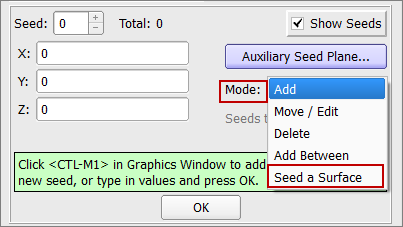

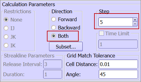

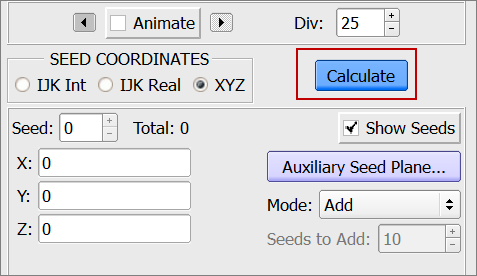

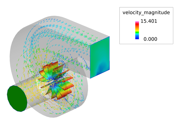

Set up Streamlines

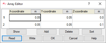

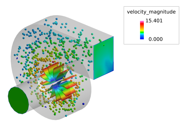

Set up Streaklines

Results were post-processed in AcuFieldView to allow you to create contour views for the pressure on the mid coordinate surface of the blower as well as the impeller blades along with new features for creating animations for contours, streamlines, streaklines and particle paths.
