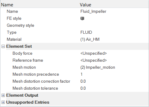

Define Mesh Motion and Set Up Boundary Conditions
Create Mesh Motion
Modify the Boundary Conditions

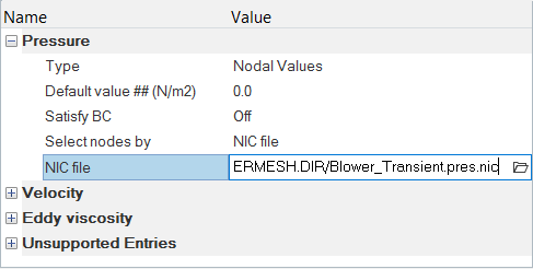

Specify the Nodal Initial Conditions

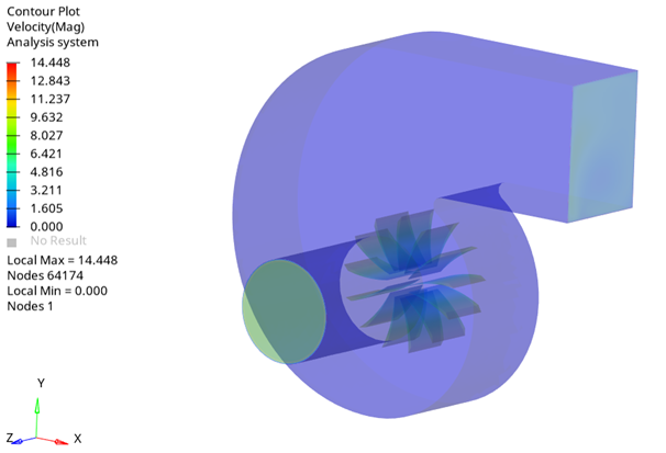

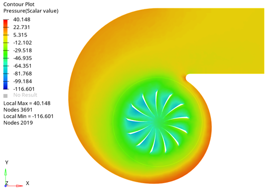

Create a Pressure Animation

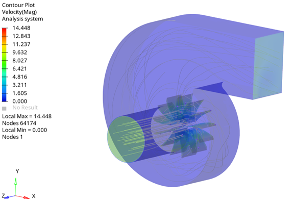

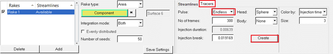

Create Streamlines
