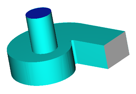

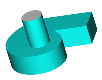

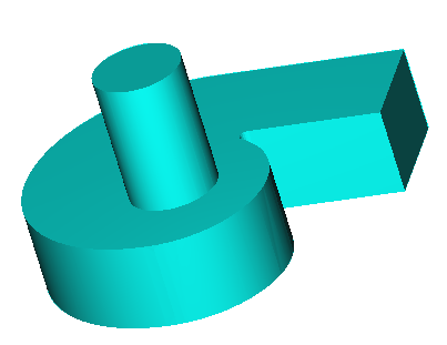

The problem to be addressed in this tutorial is shown schematically in Figure 1 and Figure 2. It consists of a centrifugal blower with a wheel of forward curved blades, and a housing with inlet and outlet ducts. The fluid through the inlet plane enters the hub of the blade wheel, radially accelerates due to centrifugal force as it flows over the blades, and then exits the blower housing through the outlet plane. Because they're relatively cheaper and simpler than axial fans, centrifugal blowers have been widely used in HVAC (heating, ventilating, and air conditioning) systems of buildings.
Figure 1. Schematic of Centrifugal Blower
Figure 2. Schematic of Fan Blades

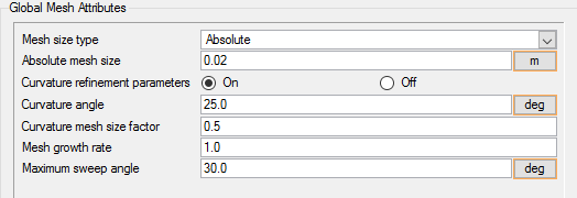

In addition to setting appropriate conditions for the simulation, it is important to generate a mesh that will be sufficiently refined to provide good results. For this problem the global mesh size is set to provide approximately 16 elements around the circumference of the inlet which results in a mesh size of 0.02 m. Note that higher mesh densities are required where velocity, pressure and eddy viscosity gradients are larger. In this application, the flow will accelerate as it passes through radial flow paths between the fan blades. This leads to the higher gradients that need finer mesh resolution. Proper boundary layer parameters need to be set to keep the y+ near the wall surface to a reasonable level. The mesh density used in this tutorial is coarse and is intended to illustrate the process of setting up the model and to retain a reasonable run time. A significantly higher mesh density is needed to achieve a grid converged solution.

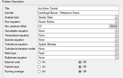

Set General Simulation Parameters
In next steps you will set parameters that apply globally to the simulation. To make this simple, the basic settings applicable for any simulation can be filtered using the BAS filter in the Data Tree Manager. This filter enables display of only a small subset of the available items in the Data Tree and makes navigation of the entries easier.
The physical models that you define for this tutorial correspond to steady state, turbulent flow.

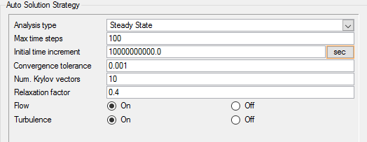

Set Solution Strategy Parameters
In the next steps you will set parameters that control the behavior of AcuSolve as it progresses during the solution.

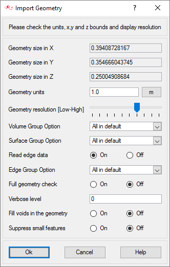

Import the Geometry

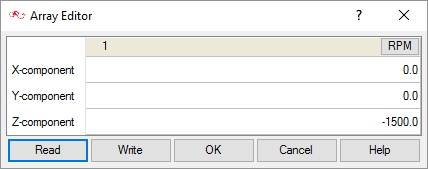

Create a Reference Frame
A reference frame is used to specify a rotating frame of reference. When specified for a volume set in domain, the elements in that volume set are assumed to be solved in the given rotating reference frame and rotational body forces are added for that volume set. In this tutorial, the fluid region near the impeller blades is assigned a rotating reference frame.
In the next steps you will create a reference frame.

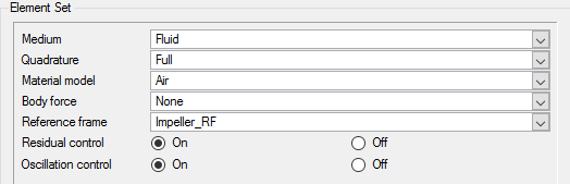

Apply Volume Parameters
Volume groups are containers used for storing information about a volume region. This information includes the list of geometric volumes associated with the container, as well as attributes such as material models and mesh size information.
When the geometry was imported into AcuConsole, all volumes were placed into the "default" volume container.
In the next steps you will create a new volume group, assign a volume to that group, rename the default volume group container, assign the materials for the groups, and set the reference frame for the impeller volume.
When the geometry was loaded into AcuConsole, all geometry volumes were placed in the default volume group container. At this point, all the remaining volumes are in the default volume group. Rather than create a new container, add the flow volume in the geometry to it, and then delete the default volume container, you will rename the container and modify the parameters for this group.

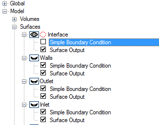

Create Surface Groups and Apply Surface Boundary Conditions
Surface groups are containers used for storing information about a surface or a set of surfaces. This information includes the list of geometric surfaces associated with the container, as well as attributes such as boundary conditions, surface outputs and mesh sizing information.

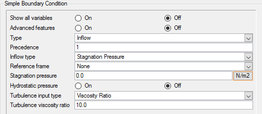

Set Parameters for the Inlet

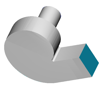

In the next steps you will define a surface group for the inlet, assign the appropriate settings, and add the inlet from the geometry to the surface group.
Set Parameters for the Outlet
In the next steps you will define a surface group for the outlet, assign the appropriate settings, and add the outlet from the geometry to the surface group.

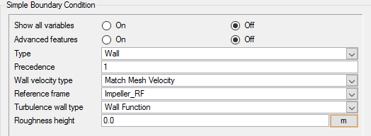

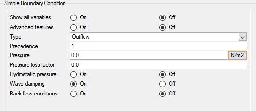

Set Parameters for the Walls
In the next steps you will define a surface group for the walls, assign the appropriate settings, and add the faces from the geometry to the surface group.
- Create a new surface group.
- Rename the new surface to Walls.
- Expand Walls in the Data Tree.
- Double-click Simple Boundary Condition to open the detail panel.
- Check that the Type is set to Wall.

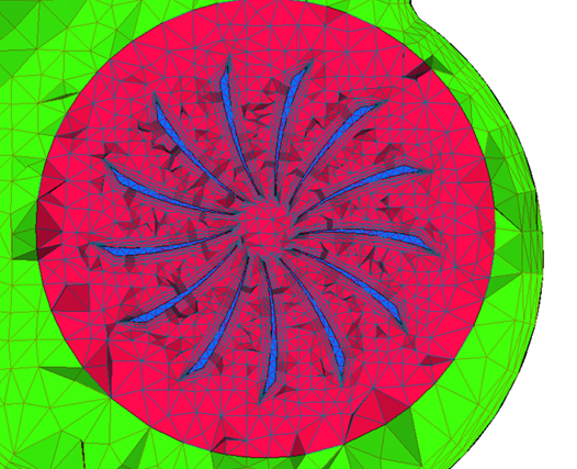

Assign Mesh Controls
Set Global Mesh Parameters
- Global mesh controls apply to the whole model without being tied to any geometric component of the model.
- Zone mesh controls apply to a defined region of the model, but are not associated with a particular geometric component.
- Geometric mesh controls are applied to a specific geometric component. These controls can be applied to volume groups, surface groups, or edge groups
In the next steps you will set the global mesh attributes. In subsequent steps you will set the surface meshing attributes.

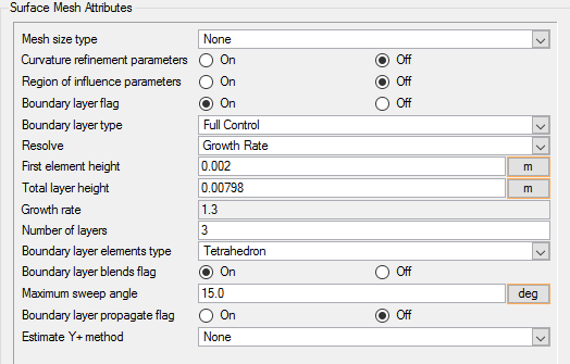

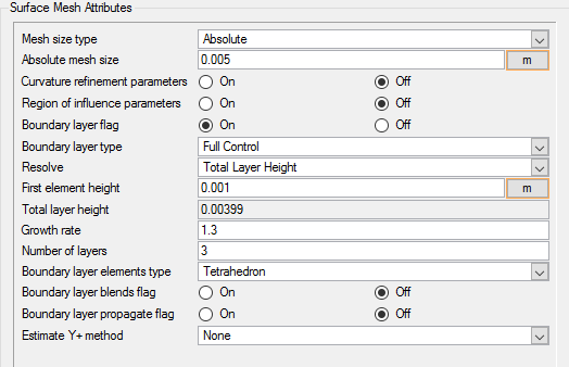

In the following steps you will set meshing attributes that will allow for localized control of the mesh size near the walls. The mesh size on the wall will be inherited from the global mesh size that was defined earlier. The settings that follow will only control the growth of the boundary layer from the walls.
Set Surface Mesh Parameters for the Fan Blades
In the following steps you will set meshing attributes that will allow for localized control of the mesh size near the fan blades.

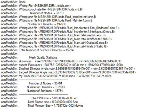

Generate the Mesh
In the next steps you will generate the mesh that will be used when computing a solution for the problem.

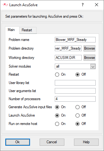

Run AcuSolve
In the next steps you will launch AcuSolve to compute the solution for this case.

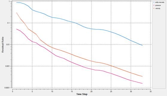

Monitor the Solution with AcuProbe
AcuProbe can be used to monitor various variables over solution time.

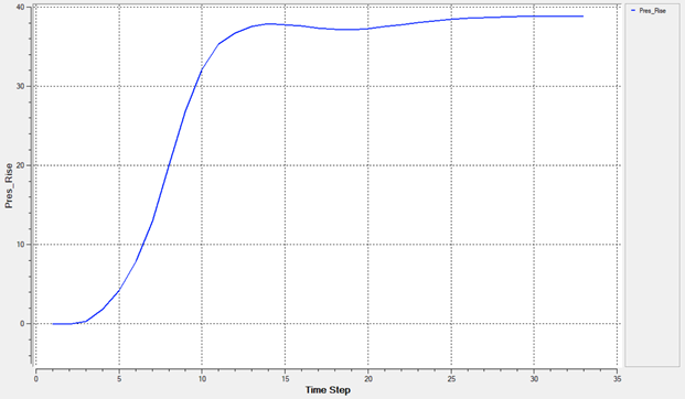

Post-Process with AcuProbe
The pressure rise between the Inlet and Outlet can be viewed using a User Function at the end of simulation using AcuProbe.

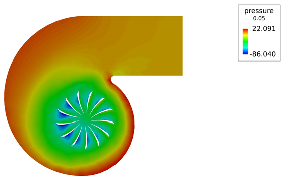

Now that a solution has been calculated, you are ready to view the flow field using AcuFieldView. AcuFieldView is based on a third-party post-processing tool that has been tightly integrated toAcuSolve. AcuFieldView can be started directly from AcuConsole, or it can be started from the Start menu, or from a command line. In this tutorial you will start AcuFieldView from AcuConsole after the solution is calculated by AcuSolve.
Start AcuFieldView

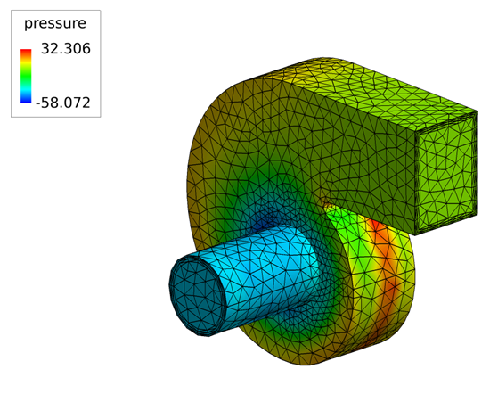

View the Boundary Surface Showing Pressure for the Outer Surfaces with Mesh
Coordinate the Surface Showing Pressure on the Mid Coordinate Surface
