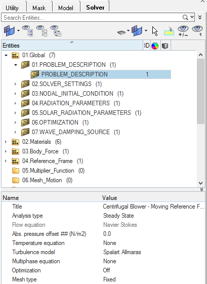

Open the HyperMesh Model Database
In this step, you will set the simulation parameters that apply globally to the simulation.

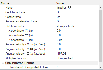

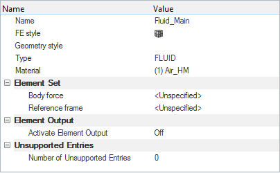

Create a Moving Reference Frame
In this step, you will create a rotating reference frame for the fluid in the impeller region so that the elements in those regions are solved in the given rotating reference frame and rotational body forces are added to that volume set.

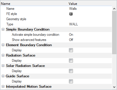

Set Up Boundary Conditions and Material Model Parameters

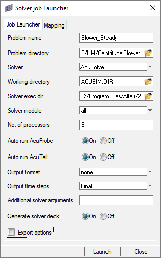

In this step, you will launch AcuSolve directly from HyperMesh and compute the solution.
Run AcuSolve

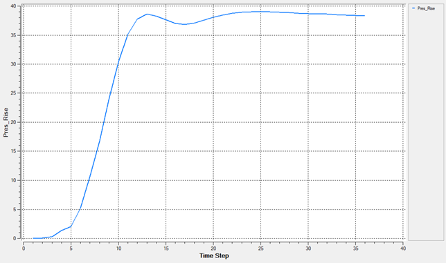

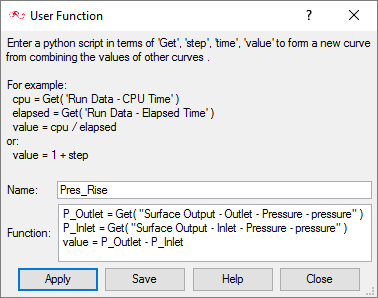

Create a Pressure-Rise Plot in AcuProbe
As the solution progresses, the AcuTail and AcuProbe windows are launched automatically. In this step, you will create a User Defined Function (UDF) and generate a plot of the pressure rise between the inlet and outlet.

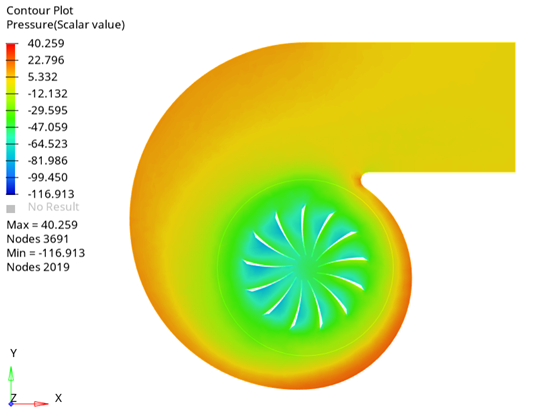

Create a Pressure Contour on a Section Cut Plane
