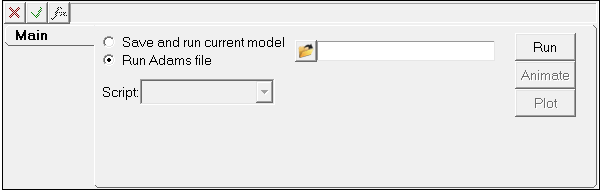

Figure 1. Run Solver panel with the Save and run current model option selected (Adams solver)

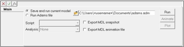

Figure 2. Run Solver panel with the Run Adams file option selected (Adams solver)

| Save and run current model | Select this option to save and run the current model. | |
| The following options are available if using this option: | ||
| Export MDL snapshot | Saves a copy of the MDL file. | |
| Export MDL animation file | Writes an .maf file which can be loaded as a model in HyperView. | |
| Script | Select a script from the drop-down menu. | |
| Analysis | Select an analysis from the drop-down menu. | |
| Run "Solver" file | Select this option to run an existing solver command file previously generated by MotionView | |
| The following option is available if using this option | ||
| Script | Click the file browser button to select a command file from the directory. Select a script from the drop-down menu. | |
| Run | Click Run to execute the solver. | |
| Animate | Click Animate to animate the results in a HyperView window. | |
| Plot | Click Plot to plot the results in a HyperGraph window. | |
