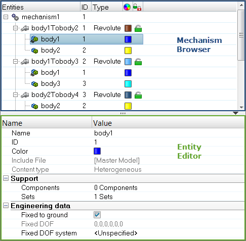

Mechanism Browser
Overview of the Mechanism Browser.
You can undo and redo actions made in the Mechanism Browser using the Undo and Redo commands on the Restore toolbar.
| Column | Description |
| Entity | Lists the mechanism, joints, bodies, and constraints in your model. |
| ID | Displays the mechanism, joints, bodies, and constraints IDs. |
| Type | Displays the joint or constraints type. |
| Color | Displays the joint and body entity colors. Body color is different from the component color set-up in the Model Browser. The body color is activated when a body is in Review mode. |
| Lock level | Displays the lock level of a joint (green = free joint, yellow = locked joint). |
Entity Editor
The Entity Editor is used to assign, modify and quickly view the attributes defined inside Mechanism Browser entities.
For example, once you create a new body or select a body in the browser, the Entity Editor opens and displays the bodies corresponding attributes, which you can view and modify.

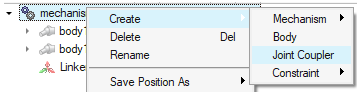

Context Menu
Supported Entities

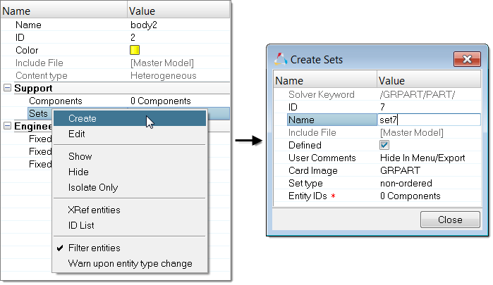

- Bodies (
) define
a kinematic assembly made of FE parts or nodes, which can be selected in the
Entity Editor. To create a body, right-click on
the Mechanism and select from the context menu. - Joints (

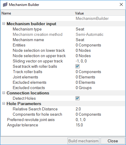

There are two ways to create a mechanism: Manual and Auto Generate. In this task, you will create a mechanism using the Auto Generate method.
- Using the Manual approach, you create the mechanism manually by defining the bodies and joints.
- Using the Auto Generate approach, HyperMesh will automatically create bodies and joints based on a selection of components and elements of the FE model.
Figure 4.
Mechanism Builder Options Table
Use this table to set options for the Mechanism Builder.
| Mechanism Builder Options | |
| Option | Action |
| Mechanism Type | Select the type of mechanism, either Seat or General. Your selection will affect other options in the dialog. |
| Mechanism Name | Type the name you want to give to the mechanism after the extraction is completed. |
| Entities | Select the FE components that define the mechanism. You can choose Components, Mechanisms, Assemblies or Sets. |
| Node Selection on Lower Track | When the Mechanism Type is set to Seat, you can select nodes on the lower track components of the seat. |
| Node Selection on Upper Track | When the Mechanism Type is set to Seat, you can select nodes on the upper track components of the seat. |
| Sliding Vector on Upper Track | When the Mechanism Type is set to Seat, you can specify the translation direction of the joint defined for the seat track. |
| Seat Track with Roller Balls | When the Mechanism Type is set to Seat, you can specify whether the seat track contains roller balls. If you check this option, HyperMesh will automatically create a double slider joint for the seat track, and an additional selector for the seat track roller will appear. |
| Track Roller Balls | When the Mechanism Type is set to Seat, and Seat Track with Roller Balls is checked, this option allows you to select the roller ball components that will be defined as third body in the double slider joint. |
| Joint Elements | Select the FE elements (springs or beams) that have to be created as joints in the mechanism extraction process. |
| Excluded Elements | Select the FE elements that should be excluded from the extraction
process of the mechanism. For example, nodal rigid bodies that are used to link components in the FE model but that are not physical conditions, can be selected here and will not be considered in the extraction process. |
| Excluded Contacts | Select to exclude tied contacts that may be defined on the FE model but do not represent physical connections. This excludes them from the extraction logic. |
| Detect Holes | Select to activate the hole detection parameters. This allows you to detect joint positions by looking for concentric holes in components. |
| Relative Search Distance | When Detect Holes is checked, this option defines the distance of search for concentric holes that define a joint location. |
| Components for Hole Search | When Detect Holes is checked, this option allows you to select the components on which the hole detection must be performed. |
| Preferred Revolute Joint Axis | Type the vector that defines the revolute joint axis. This will overwrite the direction of the joint elements. |
| Angular Tolerance | Type the angular tolerance into this field. The joint axis within this angle will be overwritten by the Preferred Revolute Joint Axis value. |

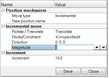

Position Mechanisms and Joints
Overview of how to modify the position of mechanism and joints.

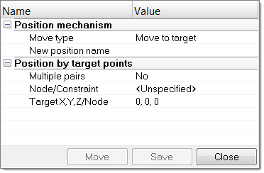

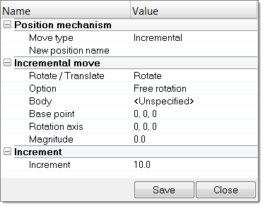

Modify the Position of Mechanisms
Modify the Position of Joints

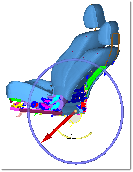

- In the Mechanism Browser, right-click on a joint and select Move from the context menu.
Modify the position of the joint.
- In the graphics area, click-and-drag the manipulator.

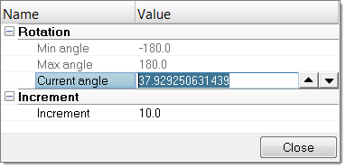

Figure 8. - In the Entity Editor, modify the Current angle
of the joint.
Figure 9.
- Change the Increment value to control the increments of the operation.

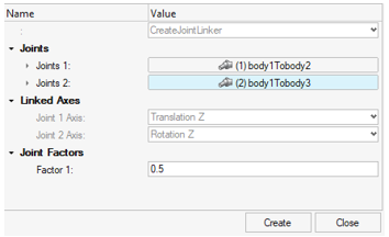

Joint Coupling
Joint coupling provides functionality that allows you to create a gear joint (coupling between two revolute joints), or a rack and pinion joint (coupling between a slider joint and a revolute joint).

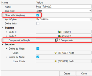

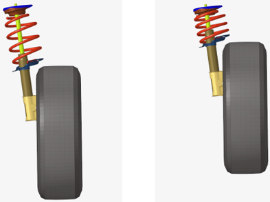

Joint with Morphing
When creating slider joints, you can select additional components that will be automatically morphed along with the motion of the selected bodies.

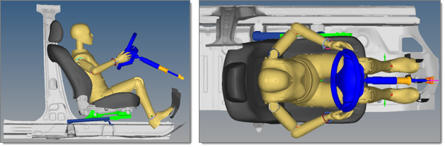

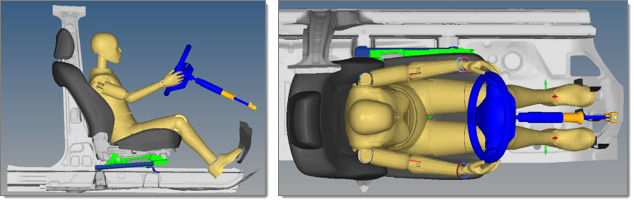

Link a Dummy to a Mechanism
In a vehicle FE model, quickly and efficiently set kinematic systems such as seats, steering wheels and pedals in different positions using the Mechanism Browser.
Figure 15. Initial State
Figure 16. After Translation of 100mm of the Seat
