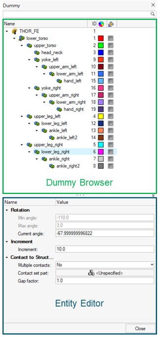

Entity Editor
The Entity Editor is used to assign, modify and quickly view the attributes defined inside Dummy Browser entities.
Figure 3.
Figure 4.

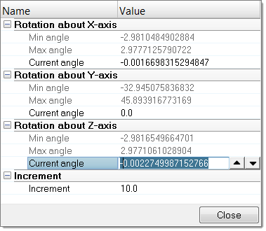

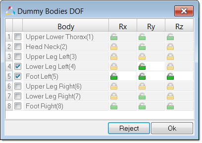

The Entity Editor is also used to modify the position of bodies. You can directly define the angle of rotation to apply in each axis of rotations in which the selected body is able to move.
Figure 5.

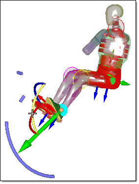

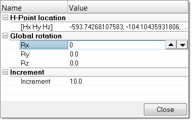

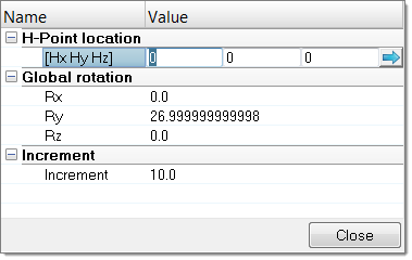

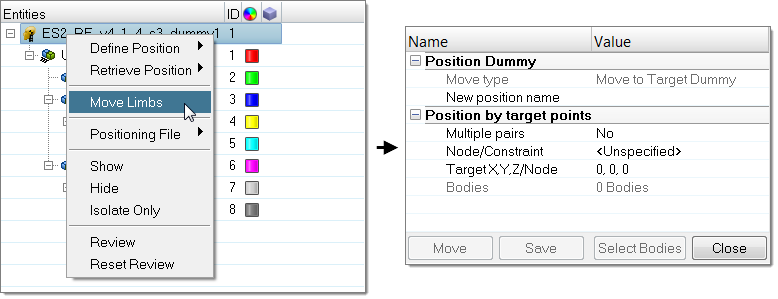

Position Dummies
Position the Body Manually
Position the Body Automatically

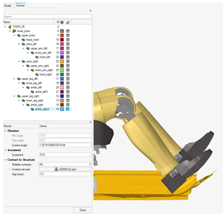

Contact Detection with Surrounding Components
Auto-contact detection allows you to automatically detect contact between dummy limbs and surrounding structural components during the positioning process. Limb motion is automatically stopped on contact detection.

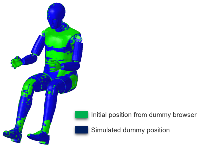

Setup Pre-Simulation
Export an input deck to simulate the deformation of the dummy.
Figure 10.
The simulation result files can be imported to update the initial FE model and thus remove the intersections and penetrations between the dummy components.

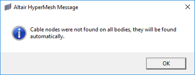

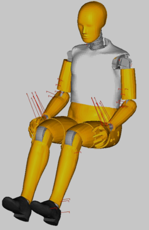

During the export process of the dummy pre-simulation deck, HyperMesh exports the complete dummy model only, positioned in the selected Reference Position, per default, the Initial Position of the dummy.
The method used for the pre-simulation is known as the “cable” method, which uses 1D elements connected to dummy bodies, in order to pull them from their initial position to their final position.

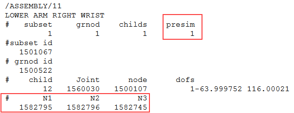

Radioss
- Simulation Parameters
- Generate XREF for initial stresses
- Create /XREF cards for the dummy components which are compatible with this RADIOSS feature in terms of material type and element formulation. The XREF cards are generated within the original session during the export of the pre-simulation deck, and not during import of .h3d file.
