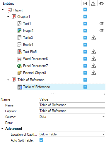

Note: Report allows you to add only one Table of Reference for the session. - Once Table of Reference is added, a chapter titled Table of Reference is added to the tree. Also, a table entity titled Table of Reference is added under it.
- Below are the properties associated with the Table entity.
Figure 1.- Name: Edit the name property of the reference table entity.
- Caption: Provide a caption for the table entity. This caption is visible in the exported Document report.
- Source: Select the data input type for the table entity. Available
options are:
- Data
- External CSV/XLSX
- TableView Window
- HyperMesh Table
- Matrix Browser Table
Advanced
- Location of Caption: Select the caption location from the list. These are standard
locations as present in Microsoft Word. Table caption locations can be:
Figure 2.- Below Table, or
- Above Table
- Auto Split Table: Provides the function to split up tables automatically based on
the space available in the slide or page.
