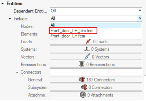

Entity Editor
Display the attributes for the subsystem if selected. Edits can be made to single subsystem selections only.
Entities
Entities are listed where the entities themselves are not visible in the browser. For example, loads are displayed because the Subsystem Browser only shows load collectors.
Nodes, elements, loads, systems, vectors, and beam sections are displayed.
Each of these entities can be selected in the Entity Editor. This invokes the selection options so that you can add to or remove from the selection, updating the contents of the subsystem.
Figure 6.
Finally, entities can also be reviewed.
