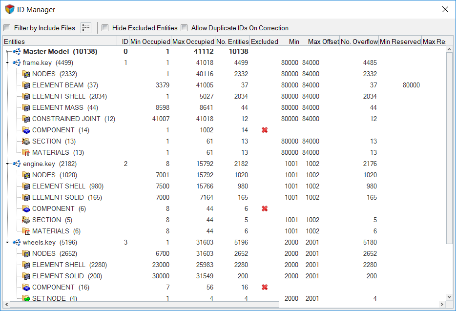

Figure 15.
ID Manager Dialog
Overview of the ID Manager user interface.
Figure 16.
| Option | Description |
| Filter by Include Files | When enabled, Include files selected in the Select
Includes dialog are filtered from the ID Manager. Click Data related to filtered Include files is saved to an .hm file. |
| Hide Excluded Entities | When enabled, entities marked as "Excluded" are hidden in the ID Manager.
Data related to "Excluded" entities is saved to an .hm file. |
| Allow Duplicate IDs on Correction | When enabled, duplicate ID pool's for supported entities are permitted to have the same IDs. |
| Entities | Displays the Master Model and its child entities, as well as each Include file and its child entities. |
| ID | Displays the ID of each Include file. |
| Excluded | Displays an X icon ( ) when an entity is excluded from ID
management operations. |
| Min Occupied | Enter a minimum integer value for the ID range that does not overlap with any
other range definitions in the model. The Min should always be:
| Max Occupied | Enter a maximum integer value for the ID range that does not overlap with any
other range definitions in the model. The Max should always be:
| No. Overflow | Displays the number of IDs in an Include file or entity folder that are outside of the defined range. |
| Min | Minimum integer value for the reserve ID range. You can manually edit the Min
Reserved column as long as your modifications do not violate the Min and Max ID
range. When you reserve all IDs, the Min Reserved and Max Reserved columns are populated using the Min and Max ID range defined at the entity level. |
| Max | Maximum integer value for the reserve ID range. You can manually edit the Max
| Conflict |
Displays a conflict icon ( |
| No. Conflicts | Displays the number of conflicts in a reserve range. |
| User Status | Indicates the status of reserve conflicts.
| No. Reserved | Displays the number of IDs reserved at the entity level. When IDs are reserved, this column is populated for the corresponding entity. All IDs within a defined ID range for an entity can be reserved, or discrete IDs within a defined ID range can be reserved. For IDs being reserved that do not fall into the defined ID range, these entities will be moved into the #Reserved column of the Master Model. If an entity type supports ID pools, the #Reserved column will display the total number of reserves applied to each ID pool in that entity type. |
| Min Occupied | Displays the minimum ID occupied by all of the entities in an Include file. For individual entities, it displays the corresponding minimum ID occupied in the Include file. |
| Max Occupied | Displays the maximum ID occupied by all of the entities in an Include file. For individual entities, it displays the corresponding maximum ID occupied in the Include file. |
| No. Entities | Displays the total number of entities in Include files and entity folders. |
| No. Locks | Displays the number of IDs that have been locked from renumbering. |
| New ID | Determines where new IDs will be placed within the current Include file
range.
If the ID Manager cannot find any free IDs using the After Max and Before Min options, then newly created entities will be assigned IDs using the Fill in Gaps option. If the ID Manager cannot find any free IDs within the defined ID range using any of the above options, then newly created entities will be assigned IDs beyond the Max ID occupied or the Max ID defined in the model, whichever one is being the highest. |
| Correction | Determines how duplicate IDs are renumbered to correct overflow.
Note: IDs that are locked or reserved in an Include file will not be
renumbered.
