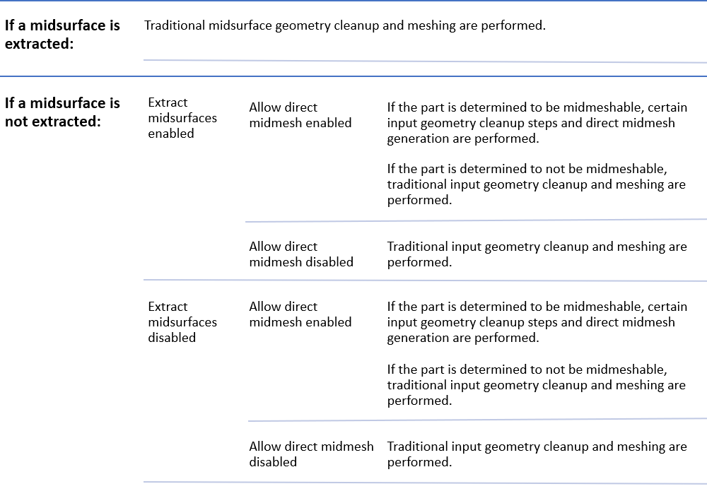

BatchMesher Midmesh Generation Rules
Midmesh generation is also supported from within BatchMesher.
